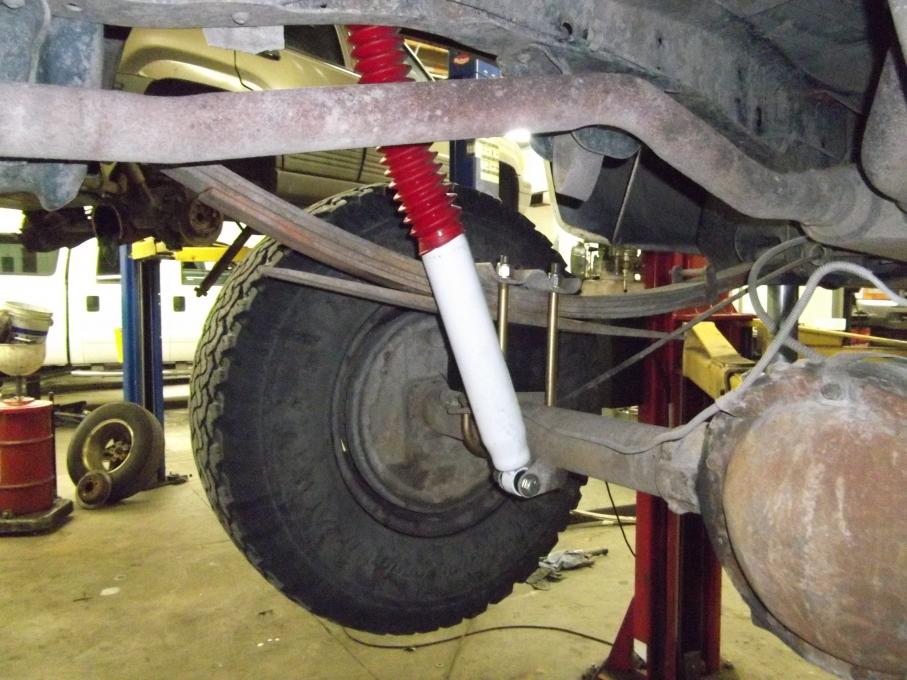

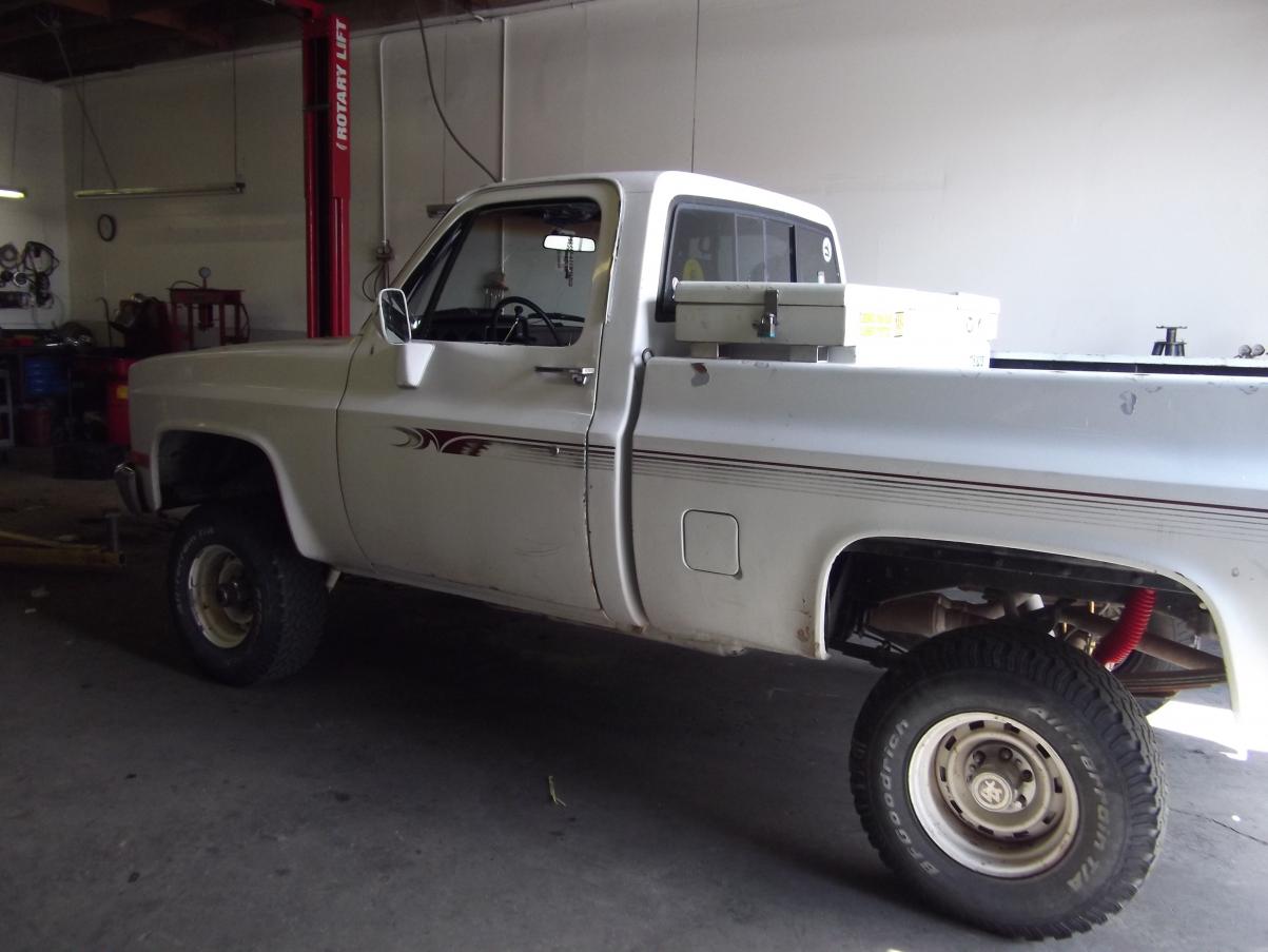

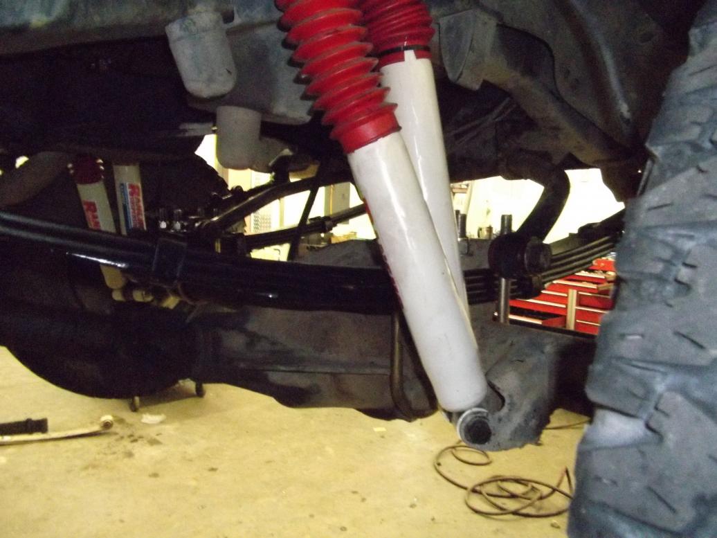

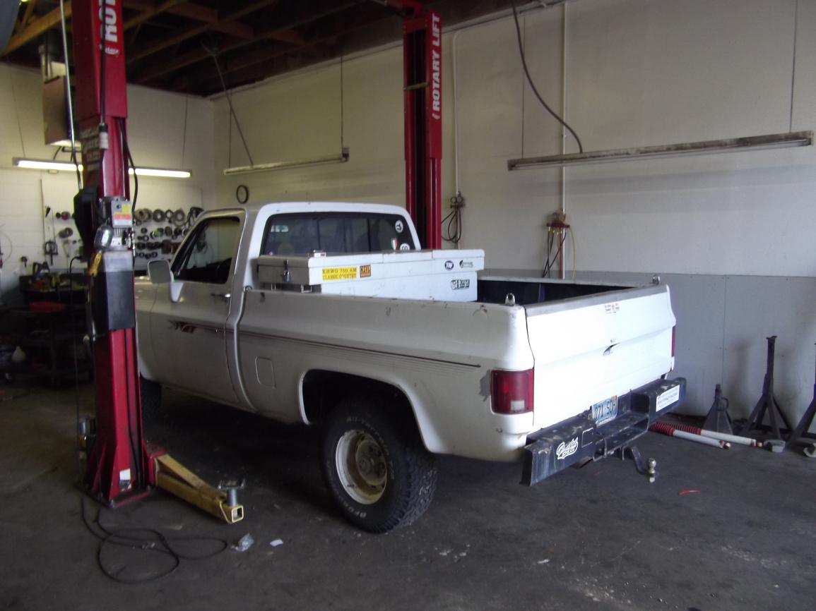

Got my 4in lift done today.Found some other issues while working on it like lower ball joints shot. We also redid all the sway bar bushings added 4 rancho shocks up front and 2 in the rear,centered steering wheel and test drove it.The ride is not to bad.I didnot use the 3 bolt arm to get better geometry on the drag link but will up grade to it later if needed.Next step is 373 gears,ball joints,new front brakes and rotors that ive had laying around.One of the guys has some 16in rims with 35s for free but I think that would be overkill.Will grab them anyway for free.I have some 15in slotted aluminun rims that will get 33s.Hope yall like it.

congrats, i had a 87 that i had a 4 inch rancho on it, rode a little rough at first but it rode good after a few miles, i did use the steering arm on it

Looks good man! Some things to keep an eye on, front & rear rubber brake lines, park brake cables (noticed yours were tight), front leaf shackles (might come in contact with frame from the longer traveling front springs using the short stock shackles), and rear wheel hop from the blocks. Wheel hop is usually more accentuated by standard trans trucks than automatics. Some things to consider down the road, rear shackle flip kit to eliminate the rear blocks for half the price of lift springs, longer front leaf shackles, and maybe a sway bar spacer if it seems to be limiting travel or making the ride harsh. But really, attitude with altitude! It improved the stance of the truck a lot in my opinion. :cheers:

BTW, on the good side, I do think it looks much better though. Is that factory front quad shocks on yours???

Truck has a really good stance to it with the lift.....:drool:

Thanks guys.This rig has 273s in it now I think the 373s would be a vast improvment. Intended use is hunting,back woods camping a little muddin.Tomorrow I will take it out on one of the goat trails I frequent and see how it dose.I really dont feel any different ride quality change but this is just around town. The 33s with the slotted aluminun are next.The 16in 35sare in my garage.Deffinatly needs more gear DUH.Oh yeah Hot Rod that is oem quad shocks in front ( I think you told me RPO Z75)If I rember correctly.

Yes sir. That is it. I was not sure if it was you or someone else, couldn't remember, I was gonna say you'd make #3 with the quad shocks, but you are actually the same #2 that I know of. I can't see why it would be true, but yours is also a GMC, a local guy here told me the quad shocks were only an OPTION to the GMC and Chevy couldn't even get quad shocks OEM. I find that a bit hard to believe, but who am I to say.

Again, I don't get jealous or envious of others trucks, but I do get jealous of their space to keep them, or equipment to work on them.
2 Post lift !!! :drool: The time, agony, aches and pains that would save.... :High 5:

Yeah HotRod havin a lift and all the tools and torches made the job a snap.Took us about 4 hours at a lazy pace including lunch and soda pop.Soda pop just in case my Boss is listening,know what I meen.HeHe.
