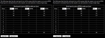

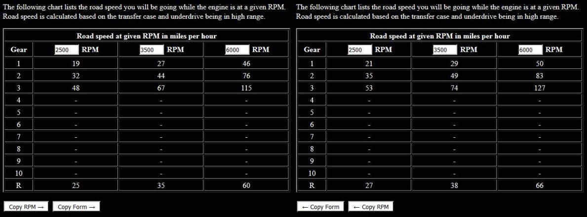

OK cool. Based on what you said, around 2500 stall, maxxing out at 6000, these would be your speeds per gear. 4.10 gears on the left, 3.73 on the right. You can tinker with the numbers here and figure speeds at different shift points...
http://www.grimmjeeper.com/gears.html
