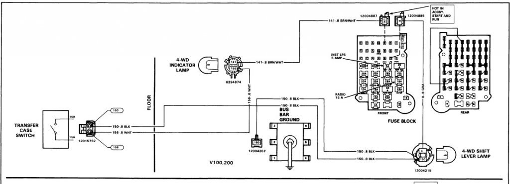

I would start by looking at the switch & making sure the connection is good. The switch provides path to ground.
What does the 4wd lever lamp do? it uses the same ground. (The 4wd lever lamp needs the headlights/parking lights on to work. If it doesn't come on- bulb might be bad.)
