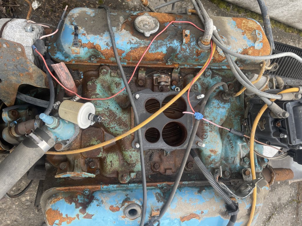

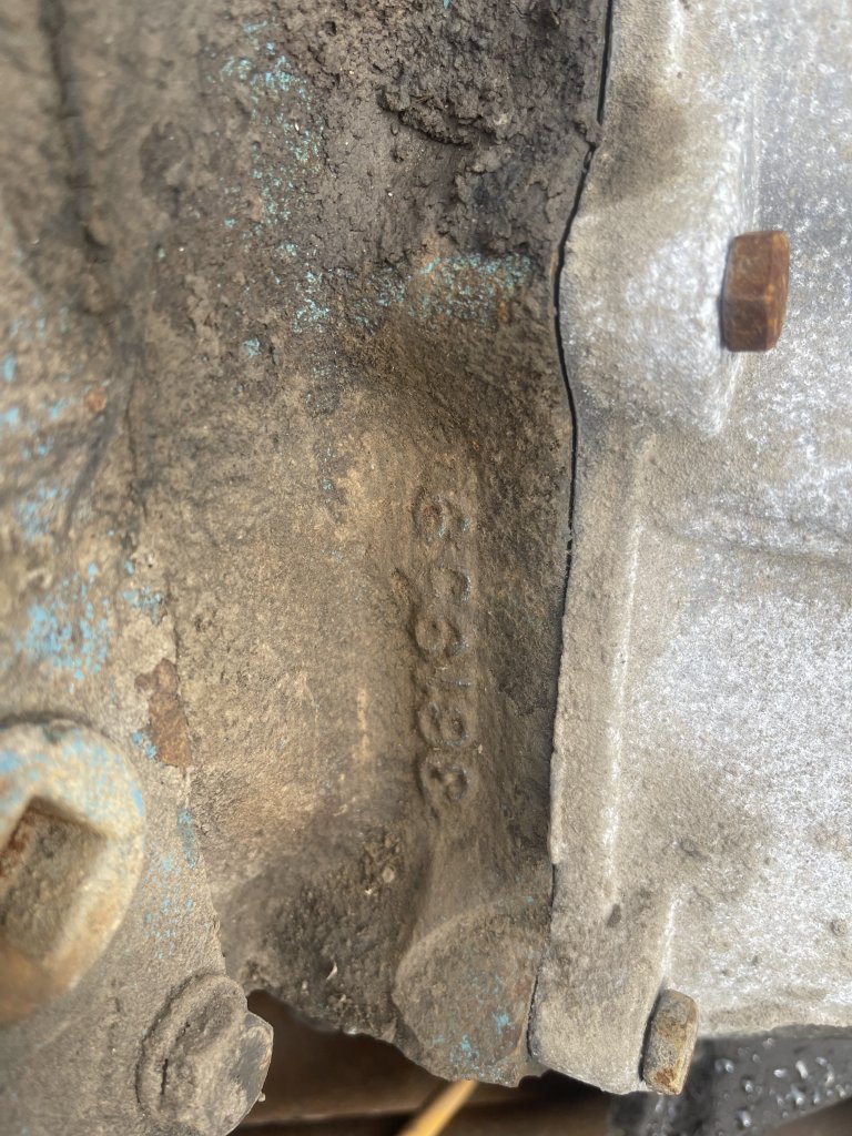

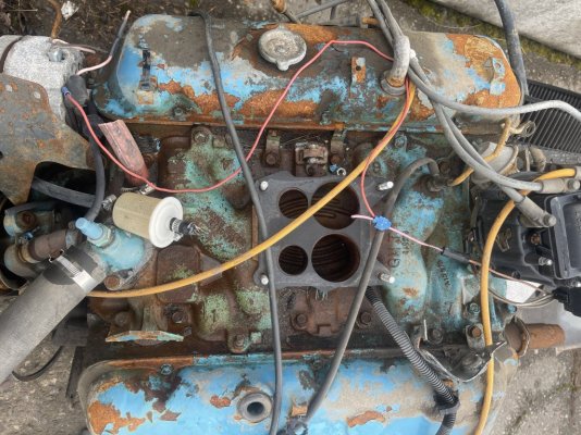

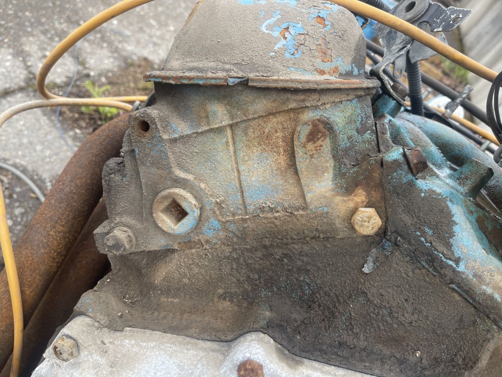

The problem I have with my location is everything has to be shipped out. In my mind, the cost to have a magnaflux and grind done on the crank, along with new pistons, could go a long way toward a complete rotary group.
My truck has 4.56 gears. I would like lots of torque for pulling heavy loads but am concerned spinning a big block at higher rpm's will be a lot more thirsty than a sb.
I was offered a 454 by a customer a couple weeks ago out of an '86 2500 (same year as mine). He is going with a crate 502 in his truck. It didn't look like anything special to me though and has been sitting out in the weather for a while. I politely passed but it is still sitting there.
Will add, taking freebees from customers can get costly. I built 2 diesel engines for him in the past year and do all the technical diagnostics on his equipment. Don't like going down that avenue.

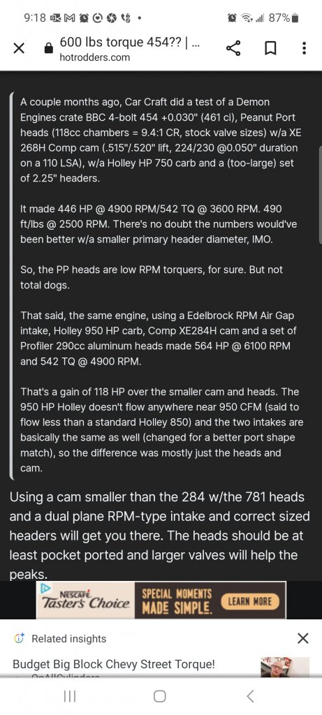

Let's do some real simple math. To get 400 hp and 400 ftlb out of a 383 I am going to have to make more than 1hp and 1ftlb per cubic inch. To get 400hp and 400ftlb from a 454 I'm going to have to make less than 1 hp/ftlb per cid. You don't have to do much to a 454 to make more than you will with a 383,and it wont have to work as hard. Demon engines 454 was a peanut port,3angle valve job 454 with a baby cam,and a dual plane . There's a reason I've got 2 454s sitting here for certain projects.
