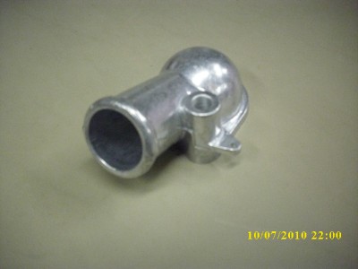

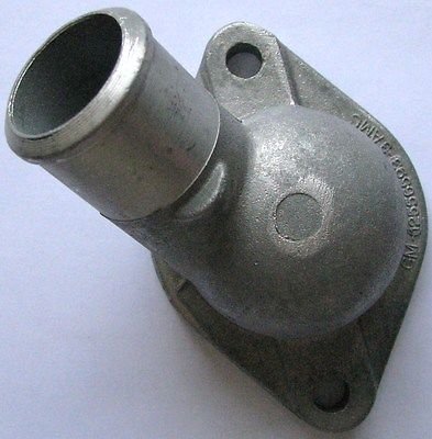

The flange section is the same and will right bolt on. What you have to be aware of is the actual neck where the hose attaches. They are all the same OD - that's not the issue.
What is different is the neck's upward angle and how it is indexed. I bought a chrome water outlet once (it was cheap and shiny). When I went to connect it - the hose wanted to kink. Closer inspection revealed that the angle of the neck was way different. Turns out it was for a Corvette - it is still sitting in a cabinet.

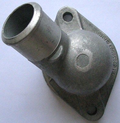

No need to replace the water outlet. The bores in the housing are just common NPT sizes. Pull your broken TVS out and screw in a 3/4" pipe plug from Home Depot. If you don't like the look of the square tang on the top of the plug, they sell special ones with a recess that accepts an allen wrench (or an upside down bolt).
