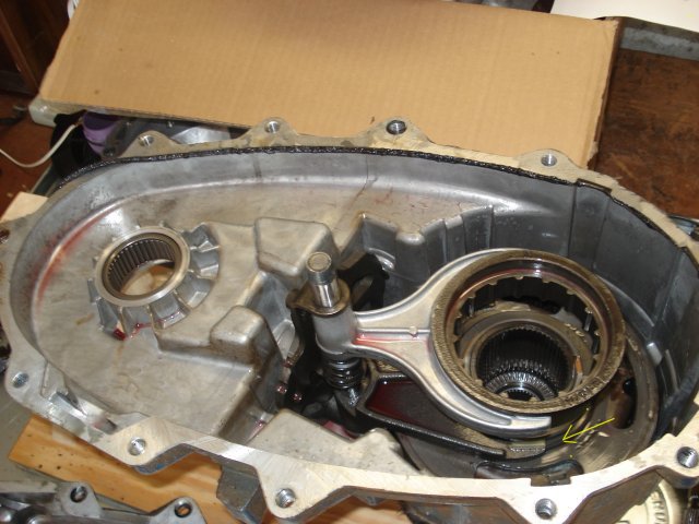

83 GMC 1500 TH350 NP208 transfer case will not pull in 2H or 4H,it just sits there making these bad grinding,bumping noises.
It does pull in 4 low without any kind of noise but it do`nt go to fast.
Just curious as to how long You people think it might go before completely breaking ???
The guy what owns it is real broke but He will be getting a 89 Suburban before the end of next month at which time the TBI and drive train components from the Suburban will be going into the Pickup.
