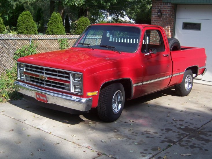

Here's a 2/3 drop with P235/75R15 tires on 8" rallys. It's cut coils in front and relocated spring hangers in the rear.
If you are like most people you will want to go lower and will want bigger tires.
