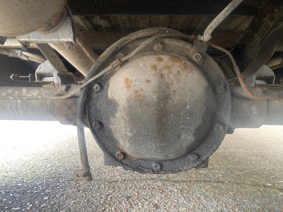

What rear axle? If it is a 12 bolt it will most likely be 1310. 10 bolts were what they call a 3r/s44. But if you have an 80's truck with a 12 bolt swapped in that would make sense.
You don't have to mix caps and stuff like that. They make crossover u joints, one half is one size the other half is the other size. You definitely have the wrong ujoint for the pinion yoke side.
It's a stock 10 bolt I think
Would really appreciate any help with part numbers etc to rectify this.
Does the pinion yoke have raised edges where the caps sit?
