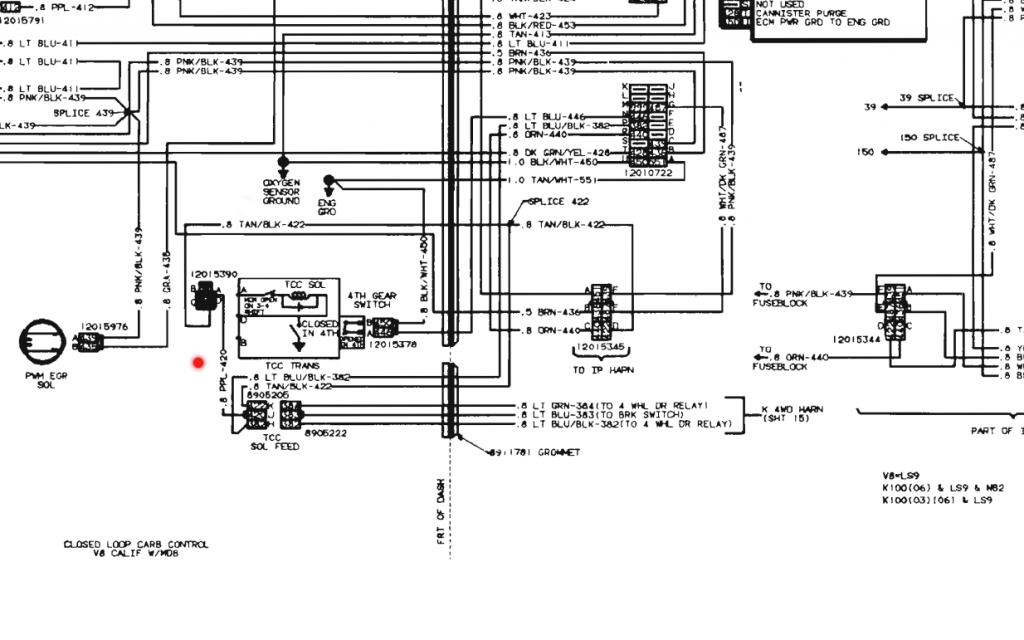

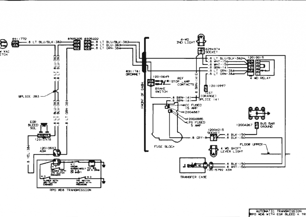

Look at the wires coming out of the transmission-(700r4) If one of them is Purple I believe it uses the ECM.
1st image is ECM & 2nd image is without

Its either that, or Manifold Vacuum referenced lockup.

One wire goes to ground, the other to the break switch.
Add a ground and see if it works?
