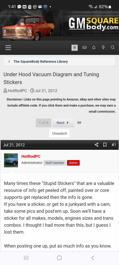

Have you searched our forumn? We have a dedicated thread to this.
Pic of the page you are looking for. I can't seem to link to it

Thanks for pointing me to that thread. Definitely worthwhile to compile as a library for other members. If I'm able to get a pic of the one I need, I'll be sure to add it.

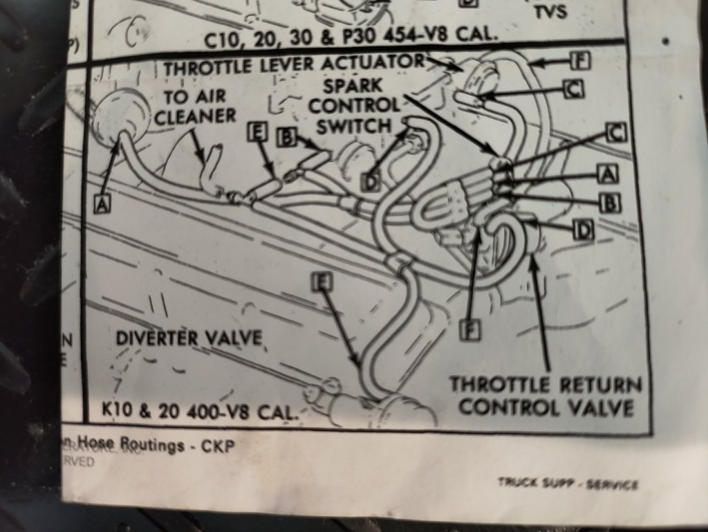

Here is a diagram from the Factory Shop Manual that I'm following. The diverter valve is connected to a port on the Qjet just behind the choke pull-off valve, and tees into the bottom port on the thermal (spark control) switch on the water neck. Note, there is also a port that goes to the switch in the air cleaner.
I haven't fully rationalized why it is set up this way, but here is my understanding so far;
- The vacuum port on the diverter valve has a constant leak. It takes quite a bit of vacuum in order for it to trigger. This constant leak needs to be factored in when you're tuning the carb.
- It is my understanding that when there is very high vacuum (deceleration at higher rpm), the diverter valve closes, and the flow of air into the exhaust stops, to prevent backfiring.
- The thermal switch on the water neck activates when the engine temp gets too high, which opens the bottom port on the switch, and also activates the diverter valve. This is to stop the flow of air into the exhaust, reducing temperatures.
Since I'm still building the truck, I don't have this fully set up yet, but it is getting close. I'll take some pics and upload in the next day or so.

Wow! The vacuum lines for the 400 are quite different than the 350! Does your manual have a diagram for the 350 with cal emission?
I think you are on to something tho with the diverter valve controlling when the air is introduced into the manifolds.

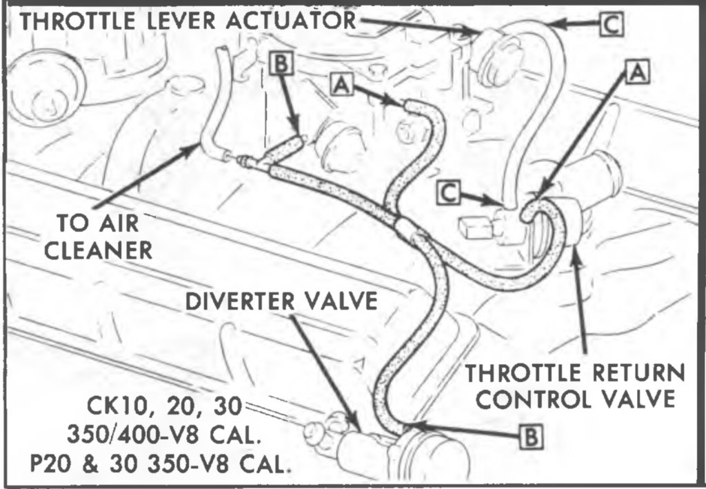

Found it!
