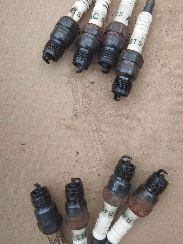

See clean vs not? The rust ones will stick, not kick out, and the worn pivots and weak springs may not pull them back proper or let them consistently and properly pivot at all. you can buy a new kit if yours are worn if they arent worn but rusty you can clean em up and use a dry film lubricant or some say a dab of grease, but ideally you dont want it to collect debris or moisture. gm would have them unlubed at all but thats how they got rusty with time. they do selll distributor lube i think but no experience. i used a crc dry film ptfe spray. After cleaning up. Made my truck stop hanging randomly high rpms and let me set idle. but the distributor was also r-tarded quite a lot , so I advanced it. i will time it eventually but its much much closer. that combined with the proper heat range plug(These were not the proper plugs and were also fouling like mad obv as well.) Combination of that all, and a carb needing to be rebuilt made it run SOO god damn rich. But with a good carb it still was rich. its better now, and it recently stopped putting piles of soot where the exhaust dumps when I run it, which tells me the carbon and build up is clearing up. the engine oil doesnt burn now and is much much cleaner much longer too. My story here is to explain how multiple things can lead to issues. also how are wires, coil, vac lines, do you have a return line on pump, do you have stock carbb(I think so?) do you have the right adjustments for your elevation, do you have good compression do you have the right firing order(Hey ive seen people miss that.... somehow), does your air cleaner properly work, does your exhaust have EFE valve and is it free, is your exhaust good? what kind of gas you use, what kind of climate and driving you have/do?
