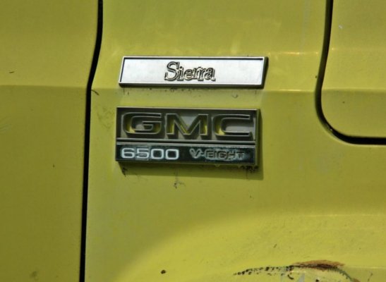

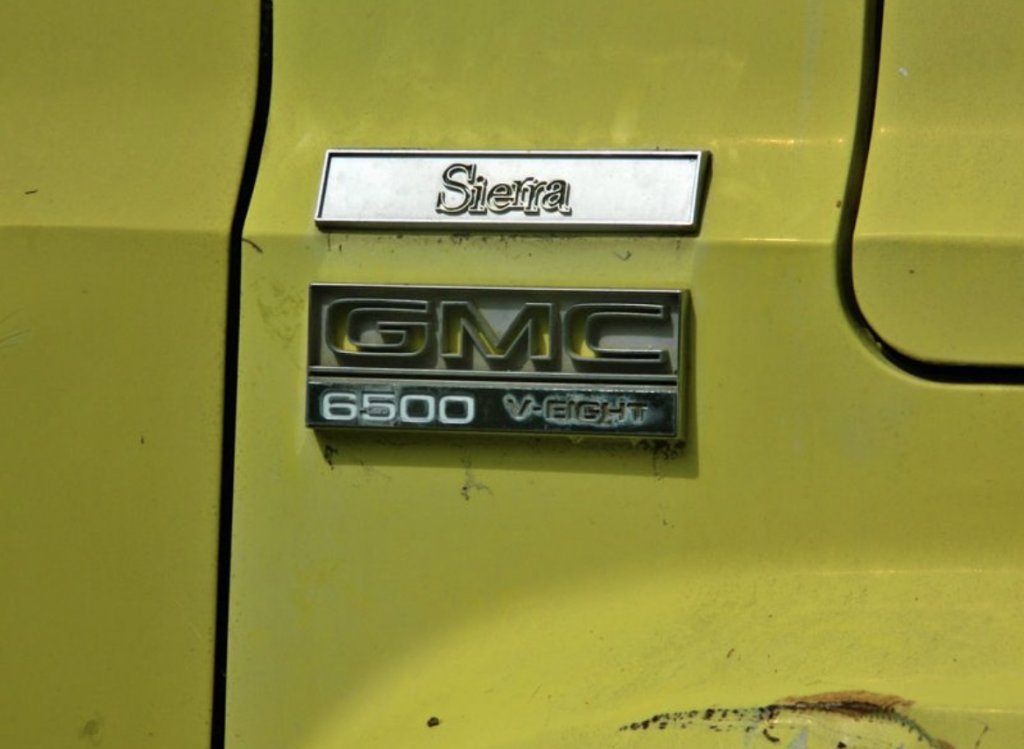

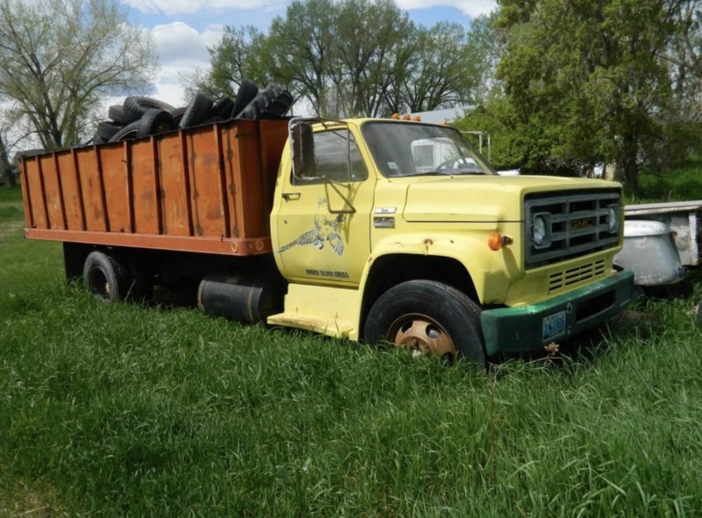

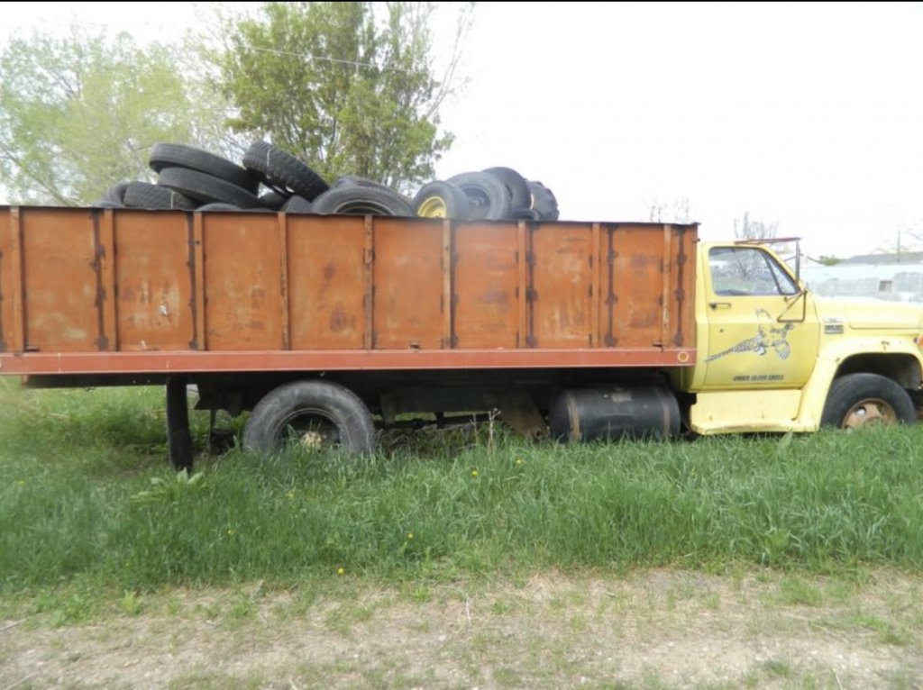

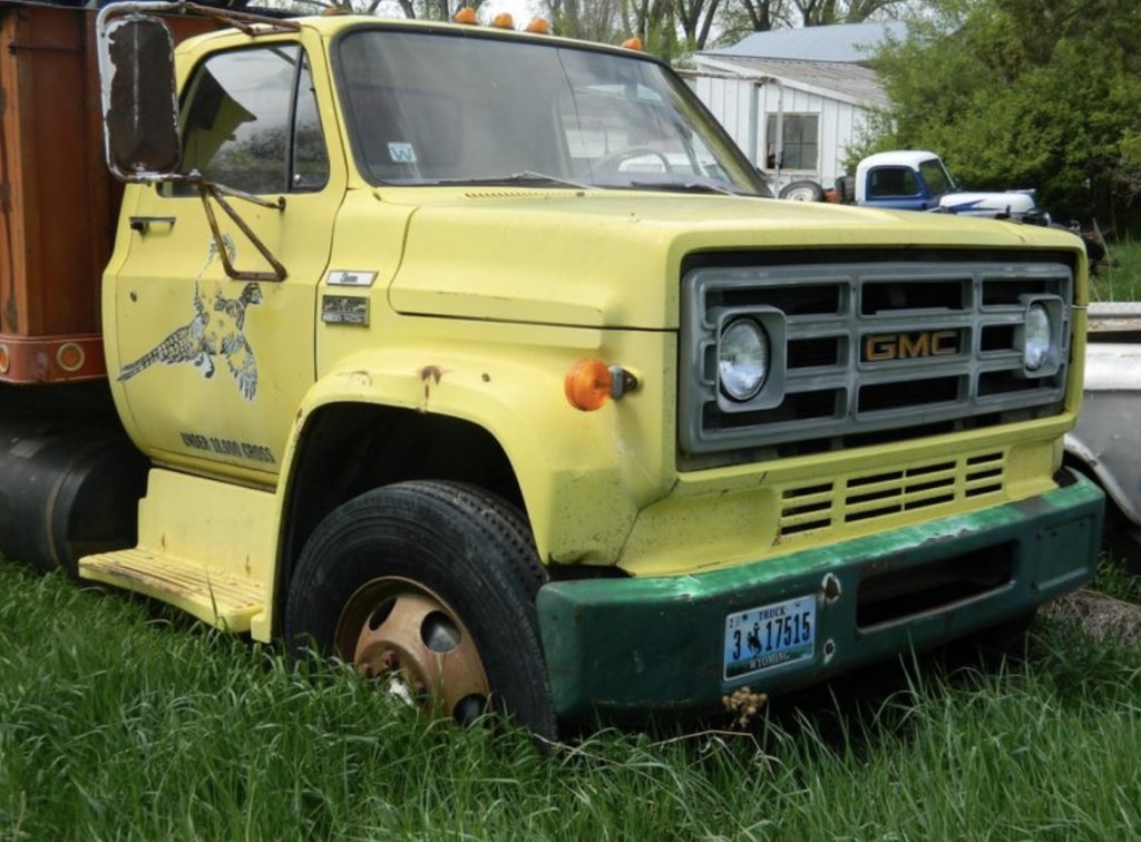

Here's any pictures if that helps, I can't figure much out the gal I'm buying it from doesn't know much, lol.
*EDIT* I know the badge says 6500, but when I ran the VIN, it said C50, so I honestly don't know. These Bigger squares are new to me.

I ended up not purchasing the C50. Unfortunately. All 4 of the duals were split rims, that were rusted towards the mounting, The tires were 10R22.5's in the front and rear, 6 on 8.5 something crazy like that and the tires were sat on way too long. They were separated and still pressurized. (Scary!) It was also sitting since 2011 which isn't bad but missing a lot of parts for the engine, also stuck in some soft mud/marsh. So even IF I had 6k to spend on wheels and tires, it still would be extremely difficult to lift that big boy off that soft ground and change all the wheels and tires. Plus, it's a 2-hour drive there and back. Just too much to do and it's too far. But I would like to thank everyone who helped me. This forum page is such a helpful community and wonderful place. Maybe if I get a large sum of money Ill go back for her, or if I win the lottery lol.
