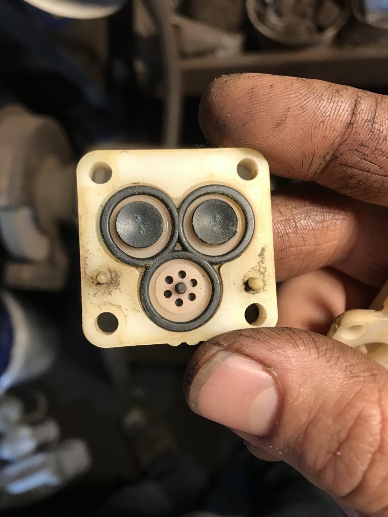

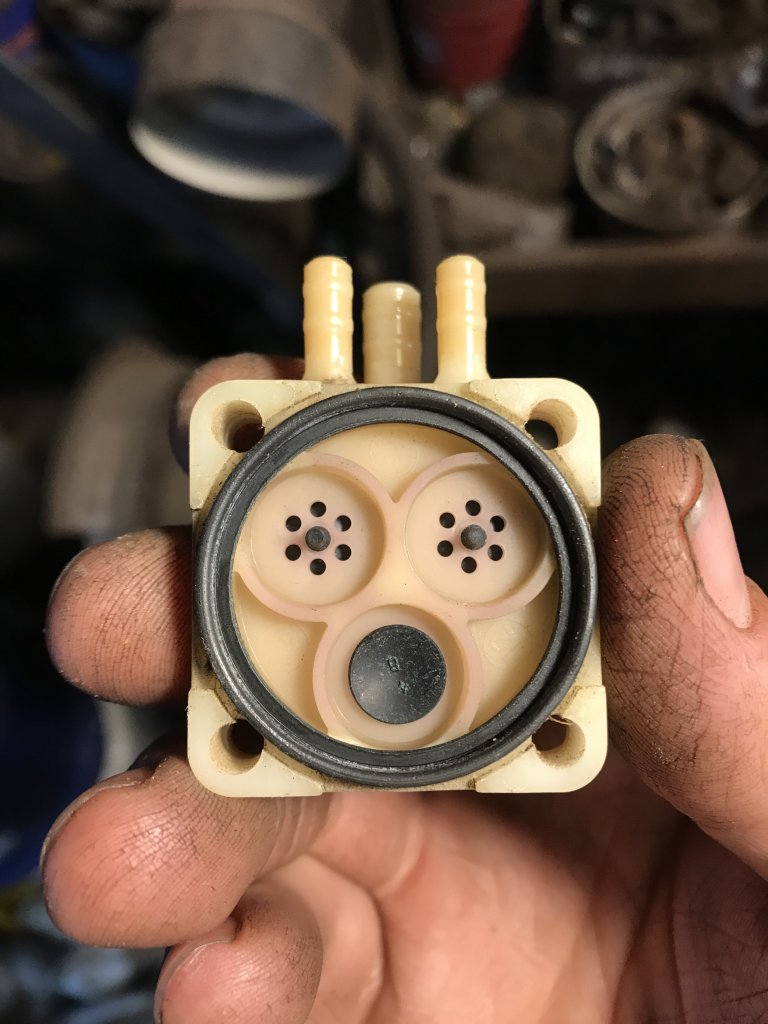

Please tell me there’s a kit to rebuild these washer pumps. For some reason I’m just fascinated with the design of it and hate the idea of just replacing it with an electric pump. The solenoid and cam all work perfectly, just the rubber check valves are so stiff that it won’t work. Just figured I’d ask. I love the old school engineering and the mechanical design over electric crap.
Ben

AC Delco makes a kit too I believe.
Trico 11-101
i found that too
ACDelco 8-6701 but it seems to be temporary out of stock till another run is done.​

I found a kit and it’s on its way. I also have several parts trucks with electric pumps and reservoirs to swap over if need but. I appreciate the offer though.
