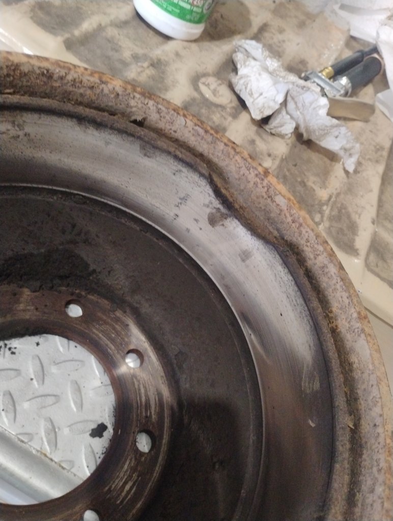

11 inch drums fix or Disk brake conversion?

Hey I cannot get the brakes to bleed in this thing.
I keep reading about the proportioning valve but if when the pedal is pressed I get a descent flow of fluid through the bleeder it's not that right?
I blocked off the fronts and the pedal feels great so if must be something with front right?
I'm tempted to try putting on my old caliper.
I've replaced the master cylinder, rotors and calipers, drums and wheel cylinders.
