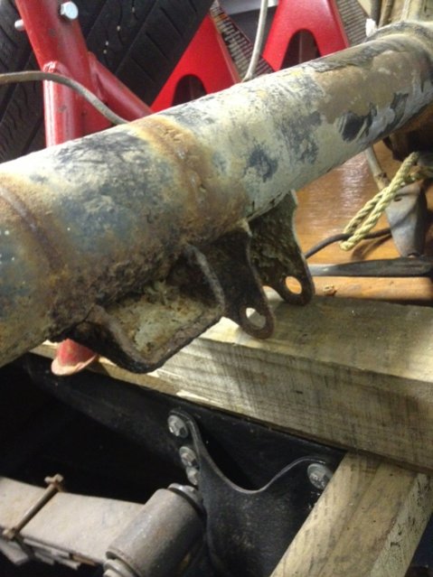

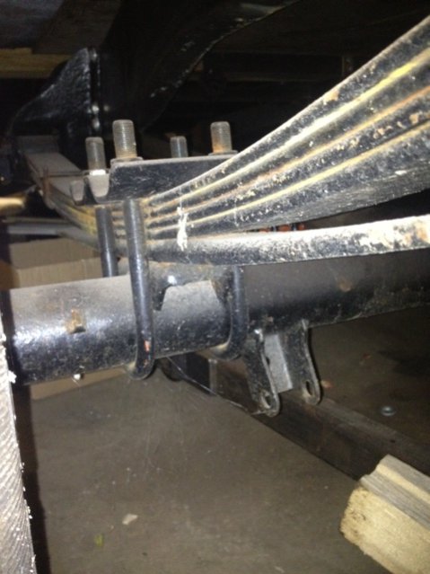

Thanks again guys. In taking a closer look at these diffs, I've found the spring perches are completely opposite of each other. my 87's 10 bolt axle has them on top of the axle tube, where the 12 bolt has them on the bottom. (came from a 79 c10)
Did these trucks use different spring sizes and configs over the years?

Looks like someone did a flip kit to lower the truck that the 12-bolt came out of. It moves the perches so the axle can ride on top of the spring, effectively lowering the rear of the truck.
