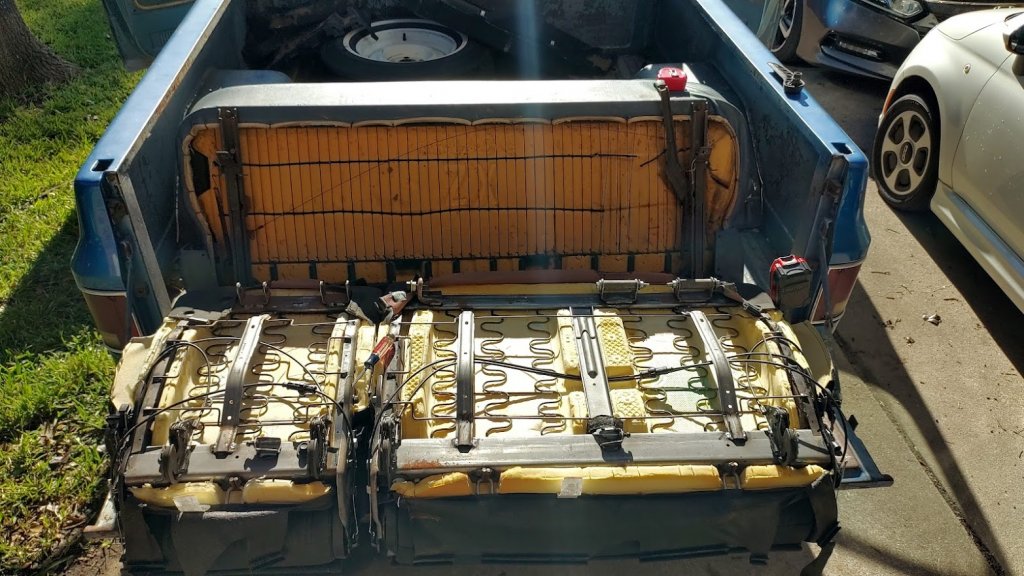

2 things, the OE seat doesn't have headrests and I don't like whiplash or my head going through the rear window haha
but seriously, the original seat is completely toast from being out in the desert sun, as is the exposed foam
Given that people are terrible drivers typically and this will be my daily driver, i want the protection from being rear ended, so i want something with an integrated headrest

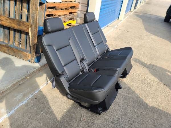

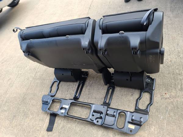

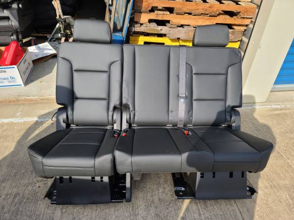

This is the seat I'm looking at getting
It measures 56.5" wide, need to pull some seat back height measurements

Looks narrow. sounds narrow at 56.5". I think you need to pull some original seat measurements first, to make sure any newer seats will fit. It would look goofy if you're centered on the steering wheel and your passenger has a 10 inch gap between the seat and the door. Besides looking narrow, you will most likely have some floor modifications to do, or get creative with the mounting brackets.

They are indeed the right width. I was going to do the same thing with earlier seats(2002 Tahoe). The problem you will have is with the mounts, they sit way too high. Most people that do this(it has been done more than once) remove the seat brackets and make an adapter to mount the seats to the stock bench seat frame. You can alternatively create your own brackets. If you try and put them in as-is your knees would need to go THROUGH the steering wheel to be able to sit in the truck.
My plan was to remove the flip down brackets and make a new frame for them to bolt on
They looked tall in the pictures

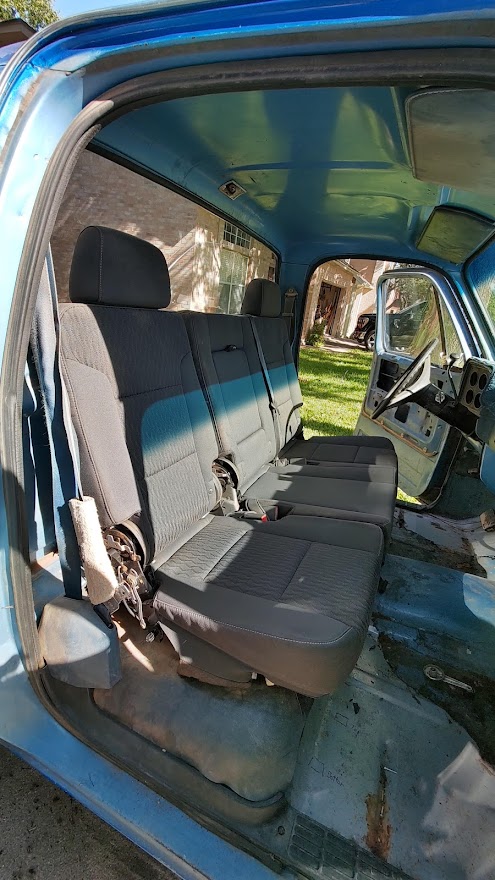

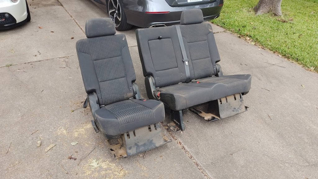

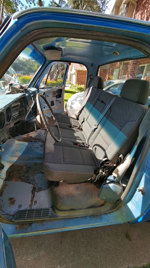

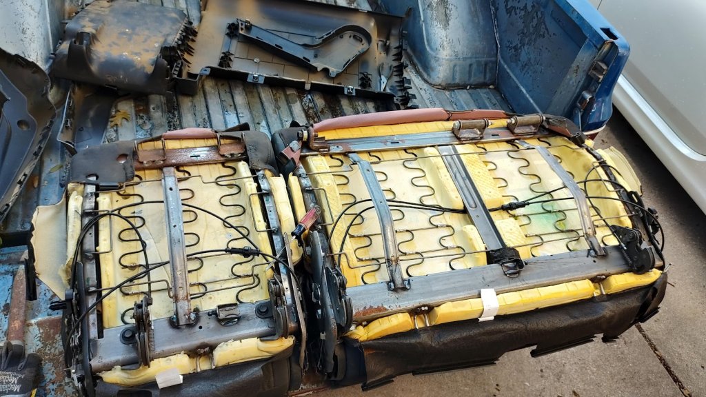

so this weekend, I pulled out the seat and started taking measurements and mocked up my new seats
the seat is a 2nd row bench out of a 2015 Tahoe, but you can use one from a 2007 to 2019 short full size GM SUV, from Yukon, Escalade etc
Im going to start working on the design of the adapter brackets, I pulled off all the old flip hardware and latches, was easier than I expected
Dont know if I will adapt to the original adjustable brackets, cannibalize the original seat frame, or build something new, we will see
I put the seat in with some 2x4s to get an idea of how it would sit, its about 1" shorter than the OE seat, which is great for me, and great since I dont have a tilt wheel

How does the recline angle compare to stock?

its pretty close, the lower cushion on the tahoe is flatter, so it doesnt have that sink into a soft couch type feel, but the low back support is better
I'll get some comparison angles later on today or tomorrow
