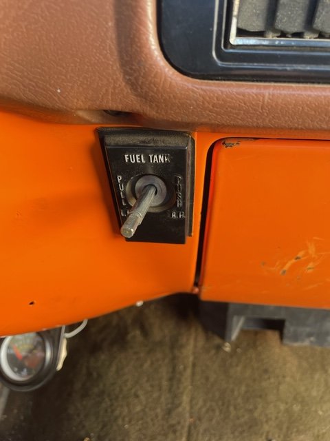

I have a 1975 C30 big block truck. I am missing the fuel tank selector knob. This truck has the push pull cable on the center of the dash. I’ve looked at every parts company that sell parts for the truck, no listing. I’ve been told it’s a 75 1 ton with a big block only deal, can’t confirm. Does anyone have a idea where I might find one? Does anyone have a GM parts book for a 75, having a GM part number might help track one down.

The C30 cab and chassis with the big block in 75 was for sure a factory deal with a cable. I’ve seen it referred to a NL2 option and that checks out with a wiring diagram from 75. There is a switch on the cable hold down behind the dash that sends the tanks float level wire to the gauges.

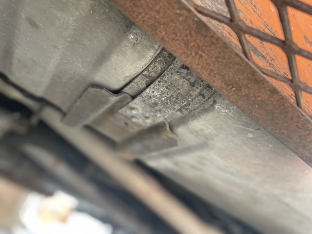

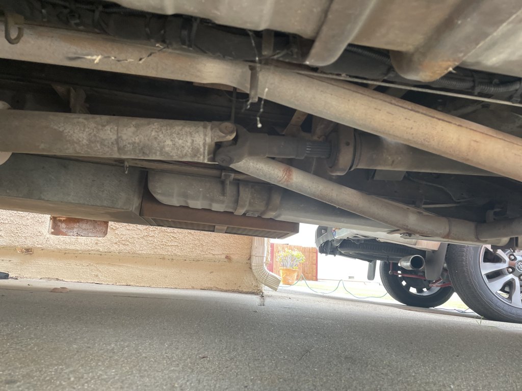

I’ll get tank pics tomorrow. Tanks are saddle tanks, looks like other ones with saddle tanks

What research I have done is the truck got the NL2 Aux tank package. Each tank is 20 gallons. As far as I can tell the tanks are just off the shelf parts GM used in the other C/K series of this era.
interesting. any pic of the "switcher" that the cable operates?
