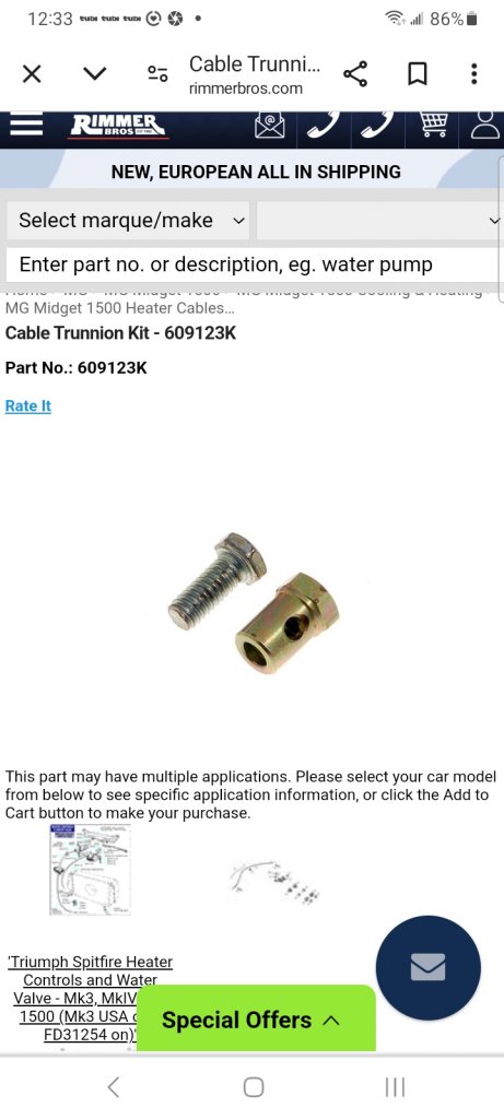

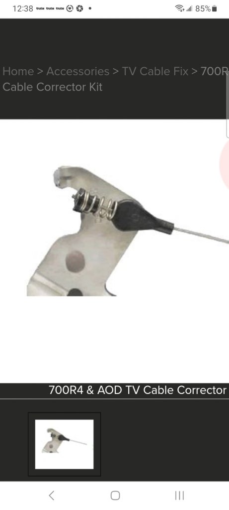

I'd think you could just push the plastic end that clips on the carbureator where you need it abd put a cable trunion ahead of the plastic piece so it can't slide back up,you can also put a compression spring between the plastic end piece and the cable trunion for more cable tension.
