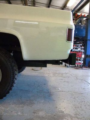

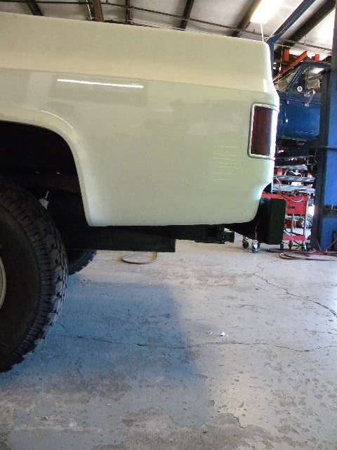

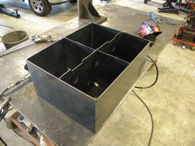

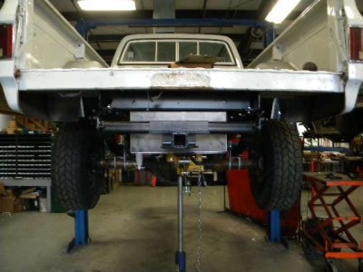

My tank
Here's what my shop did for my fuel tank relocation. It's got a 32 gallon capacity. Not 100% complete yet so pics are of mock-up. Outside will be powder coated black & the inside gets a special coating to prevent corrosion. We used a new stock style 2008 Chevrolet 2500HD pickup assembly to keep it compatible with the motor I used as well as to make it easier down the road when it's time to replace it or work on it!!!

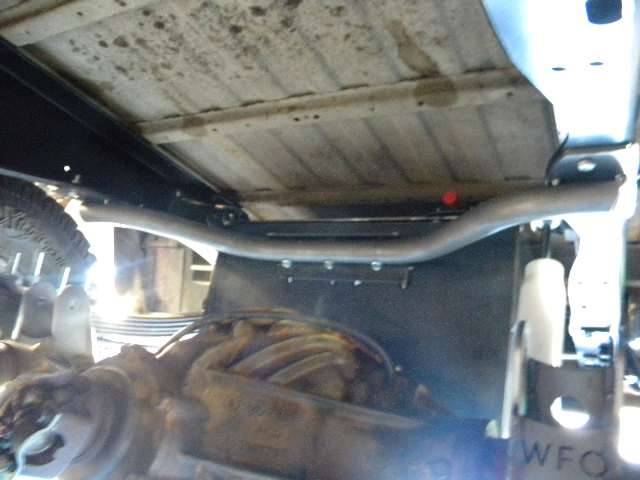

I know this is dead. But as a newb here I figure I would drop a little more info to the sticky.
First I cut out the spare tie mount. I didnt take a pic of the brace but you will know what I'm talking about. Then I bought 6ft of 1 1/4" box tubing (.125" wall). I then trimmed the edge of the rear brace where it rolls toward the back of the truck. I used this as a guide to keep my tubing straight and it also made a nice V channel to weld to.
Then I added the cell and straps with another rough cut piece of tubing and squared it up as well as leveled it out.
Then I cut so 1 1/4" angle to make mounting tabs. The cell wont just lift out because the fittings on the sump catch the rear brace. The tabs make the whole thing removable. One side is vertical the other is horizontal. That should keep it in place.
I covered the whole deal in POR 15 and called it good.
Then it was on to the fuel pump. I had everything on the shelf from many other incomplete projects. So this was easy. The pump and filter are circa 1992 but they are new and do what I need and that is get me to work and back.
And the final touch. Cutting a hole. I am currently building a stainless door to cover it.
