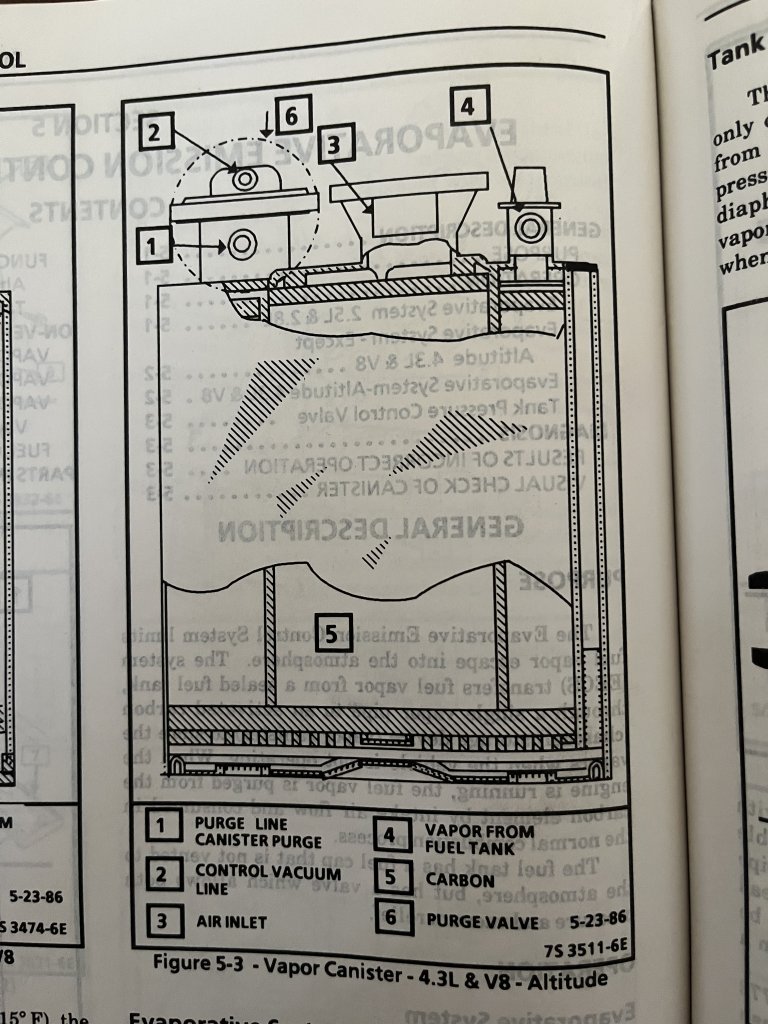

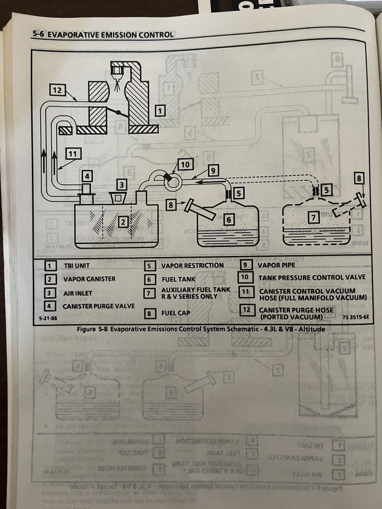

If the charcoal filter gets clogged, this can cause a filling issue. Purge valve (on the charcoal can) could be bad. Fuel vapor okay, if raw fuel gets sucked in it will melt the charcoal.
If it gets clogged OR on trucks with the “high altitude emissions system” like mine there’s a in-line valve just ahead of where the tank selector is. Previous owner had disconnected all that and left it loose and hanging and drilled out both gas caps to vent. Since I didn’t know any of that I replaced both gas caps when I bought the truck and popped a line on one of my tanks because of the built up pressure. Without the clamps on, that “tank pressure control valve” couldn’t receive the vacuum required to open up, meaning that the tanks couldn’t vent to the charcoal canister and then on into the TBI, so pressure built in the tanks until it popped a line. Drove me crazy trying to figure out what was going on until I found out what the problem was.

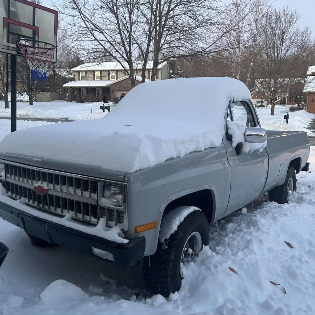

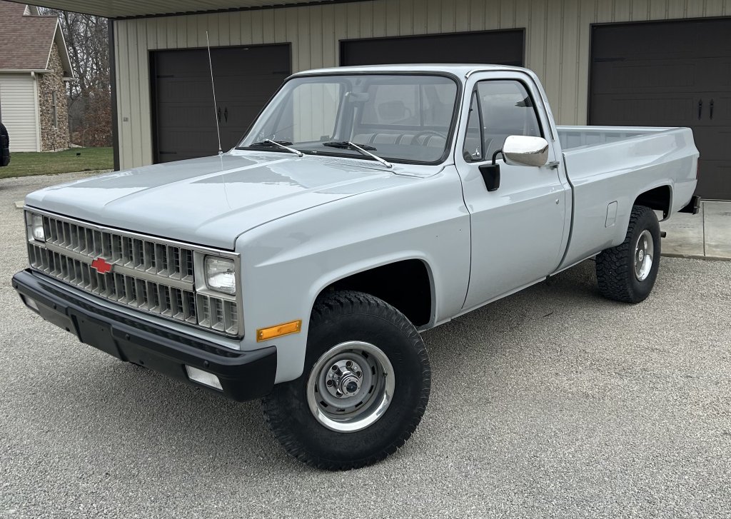

I think that was the problem. I think it’s the left side that’s working not the right. I only went by what the guy said. The cool thing is that it’s single degrees out with 10” of snow on the ground. The trucks been outside for about a week. Oh well. No pictures of the underneath right now but this is what I got.
Really nice looking ride you got there!

Well, correction on the correction. It IS the passenger side that is the main tank. I filled the left side and it’s still full. The passenger side is less now. I went to put in a new tank selector valve underneath valve but I think he was the hoses incorrect. Taking off the bed won’t be helpful because the sending unit and stuff is under the cab. So looks like the best is to drop the tanks and figure things out. Going to be fun.
Wow! What a beauty! Thought it was white until the snow pic. Nice work!
