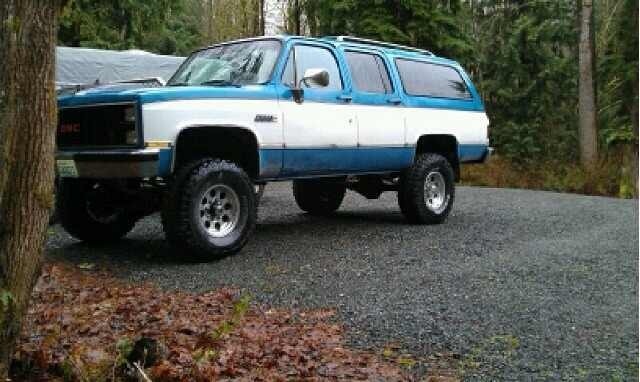

Well it's a 87 suburban 2500 lifted I don't know how much just clears 35s but I want 38s because the 35s drag my front and rear diffs on the trail to where I like to fish I don't know what all has been done to it I bought it this way
1911_colt
Dec 9, 2012
27
Washington
Michael
87
Suburban 2500
Here is a picture of it like I said 35s i don't know what Alls been done
