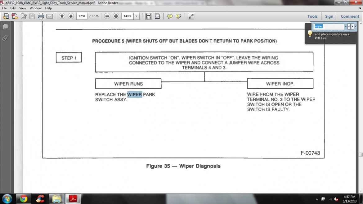

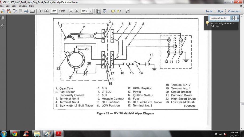

I just can't seem to figure this out, wipers won't delay or park. Already replaced motor, wiper pulse module, and wiper switch. Anyone have any ideas, i am open to any and all suggestions. This is a 1987 v2500. Thanks for your time
