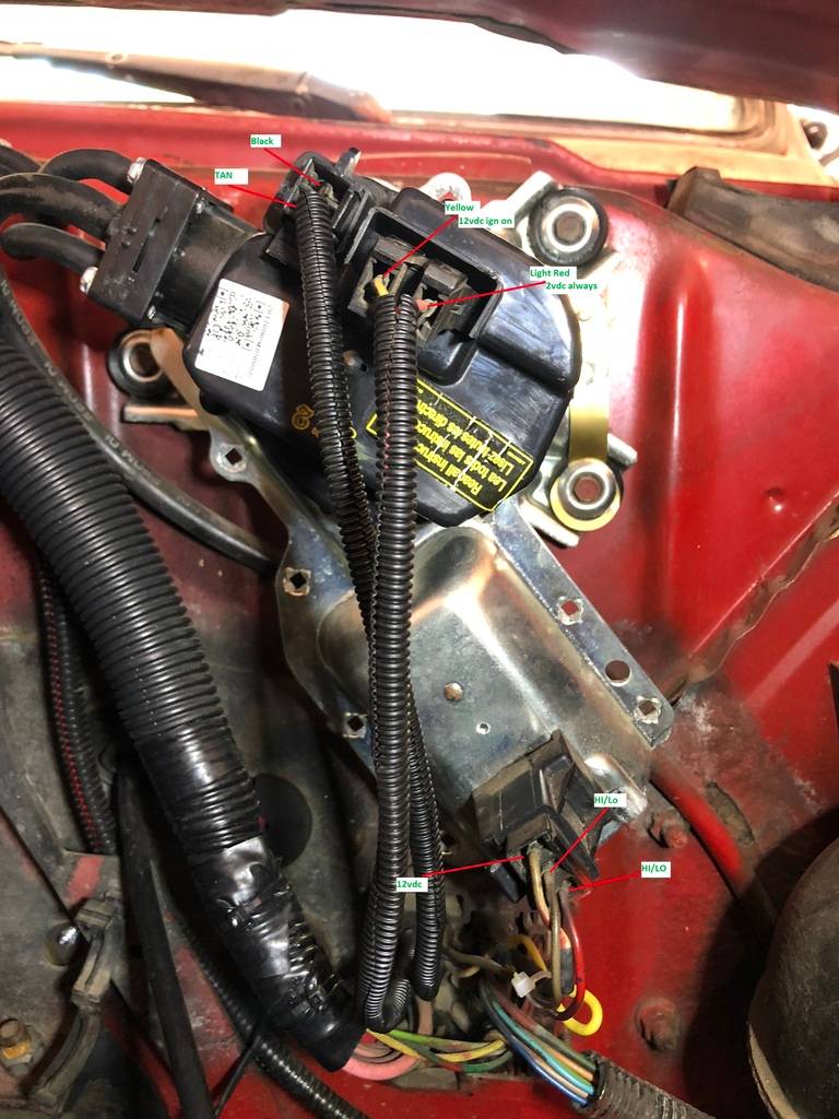

Hey guys,
Trying to figure out a little washer/wiper issue. So I have a 84 GMC with pulse wipers and washer. The wipers seem to work fine until I try to use the washer. When I press the squirt lever the pump just clicks and then the wipers stop working. Then the wiper will not start working again for some time, just random it seems. The wiper motor / washer motor I have has 3 plugs going into it. A 3 wire connector on the wiper motor, a wide 2 prong connector with a yellow and a light red wire and then another smaller 2 prong connector with what appears to be a grey or tan wire and a black wire. I can't seem to find a wiring diagram with this connector setup anywhere. I've checked and I'm getting 12v with the ign on to the yellow wire and about 2 amps on the light red wire at all times somehow. Anyone got any ideas or diagrams I can try or look at??

This may shed some light . . .
  • Detailed Wiper Wiring Diagram.doc

Ok guys, so I replaced the module, replaced the switch in the steering column but still have a the slow/weak wiper situation. I still get a much better result when I jump the ground/purple at the motor to an additional ground. I've tested the all wires and I'm not getting any reading above .4ohms and I'm getting a full 12v at the motor. Any more suggestions?
31,897
32,700
The popping/ticking you hear is more than likely the washer pump mechanism malfunctioning. It's very common. It may also be binding and causing the weak wiper motor to stop working.
On my '84, I got a wiper motor for an '85-up that used a remote mount pump. Of the two 2-wire connectors, the larger one is for the washer pump. You can use those wires to power a universal electric pump, or to power an in-tank pump if you switch to the '85-up washer bottle.
