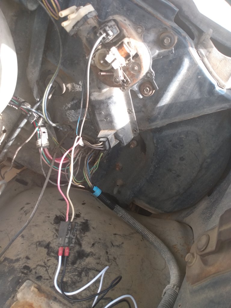

Thank y'all for the help! Got the new pump and wired it up and now works great.
That plug you're tied into, from what I understand they're both + and when you engage the washer switch one of those wires grounds out?
I'm just trying the same thing and nothing happens when I hit the switch .(Stays +)
I took the switch apart, it was a little dirty but didn't change anything once cleaned up.
Is there another obvious thing I missed?
Does your pump on the motor work when you hit the button? IIRC when I put the test light on it one had power even when the button wasn't pressed. I just hooked the positive side of pump to that wire and negative side to the other wire. And it worked. I can double check when I get home if you want me to.
If your pump on the wiper motor doesn't come on(mine did come on)then your switch might be bad. And that's why it's not coming on.

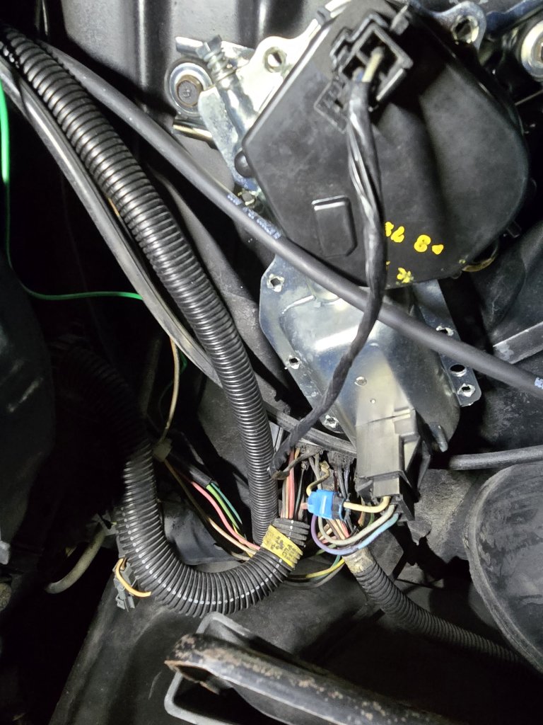

The pump never worked since I've had it. My switch must be bad, the wires both are + and nothing changes when I hit the switch.
The pump I plan on using works I hooked it up to test in the second pic and it turned on(whichever way you moved the switch)
*I took the switch apart and cleaned it up broke the spring that returns the switch for washer but still slides around ok.

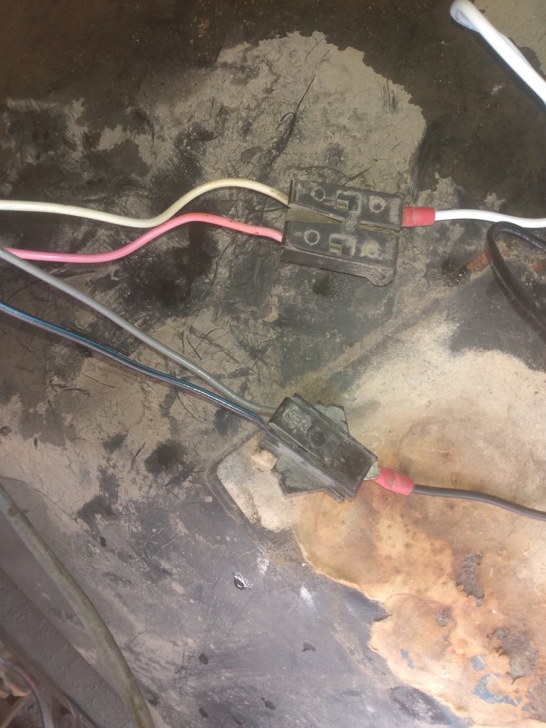

I'm having trouble with my washer pump also I'm getting power through the pink wire to the pump I think white is ground wire, pink and white going to pump I bought new wiper switch
thinking it was switch just plugged it in did not dismantle Colum no washer question #1
does this switch need to be grounded question two#2 where does pink and white go back too? there is a wire clip on white with small cut red wire do I need that ?

See your other post about this problem.
Washer- White wire brings volts from fuse block. Pink wire goes back to switch to ground circuit when selected.
Black wire at switch grounds. If your wipers work, the switch is grounded properly.
Wipers- White wire also brings volts to wipers. The other color wires go back to switch to ground whatever speed is selected.

This is how I wired mine. Works great now.
