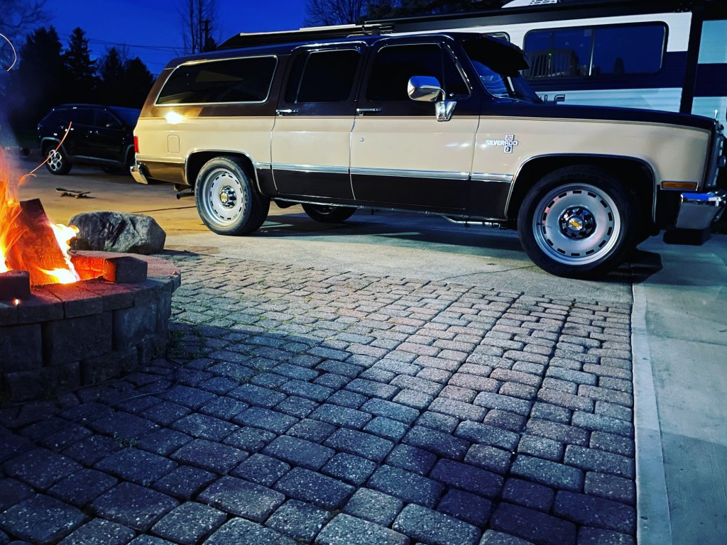

I have done front springs and rear shackle so about 2-2.5" would like to go more and try to avoid a c notch but not totally against it. I was thinking spindles (if they're ever in stock) but not sure how to approach the rear, would like to keep some ability to tow.
Does anyone know what this exact wheel and tire package is? Are these 20" wheels or 18"? Tire size?
Thanks!

Test fitting 20” Detroit steelies before powder coat. Next up, 2/2 drop:
did you ever do the 2/2 drop? I've been doing a bunch of research trying to find the best solution for my 89 R2500 and there's not much information out there. Best I can see is 2.5" C20 drop spindles and 2" shackles for the rear from Western Chassis. I just want to go a bit lower while still being able to utilize the airlift bags for towing our enclosed race trailer.
