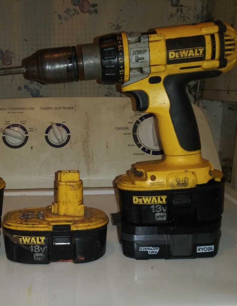

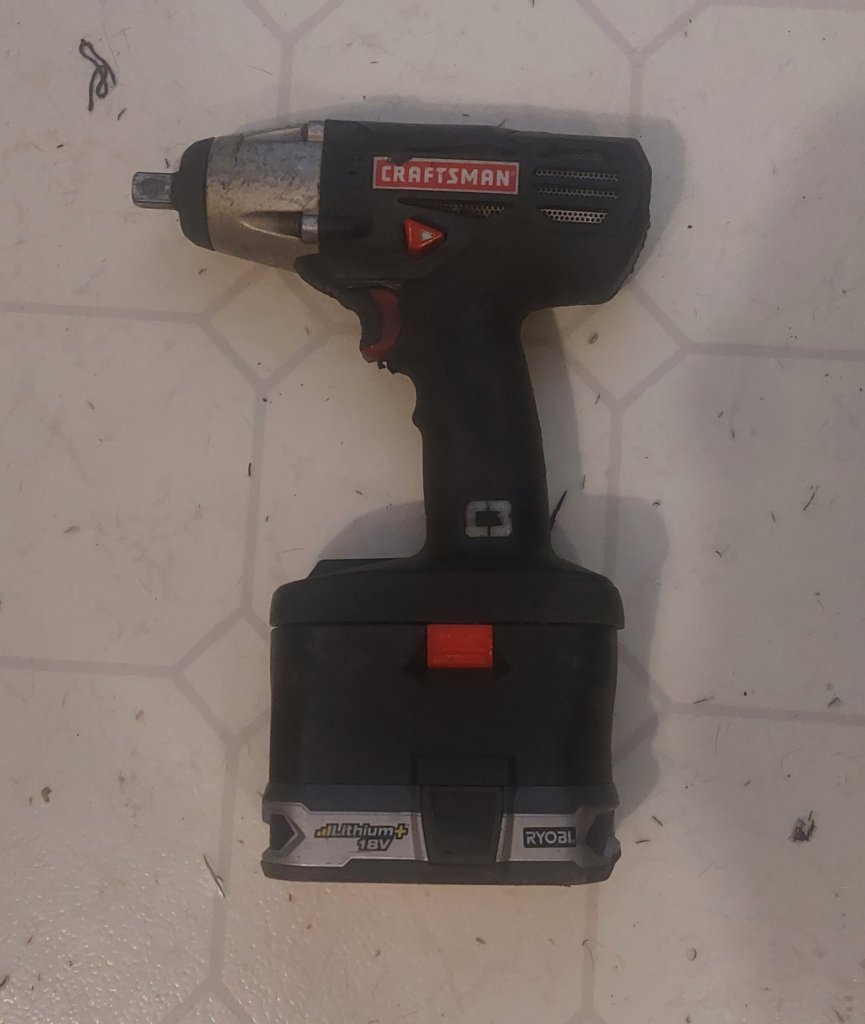

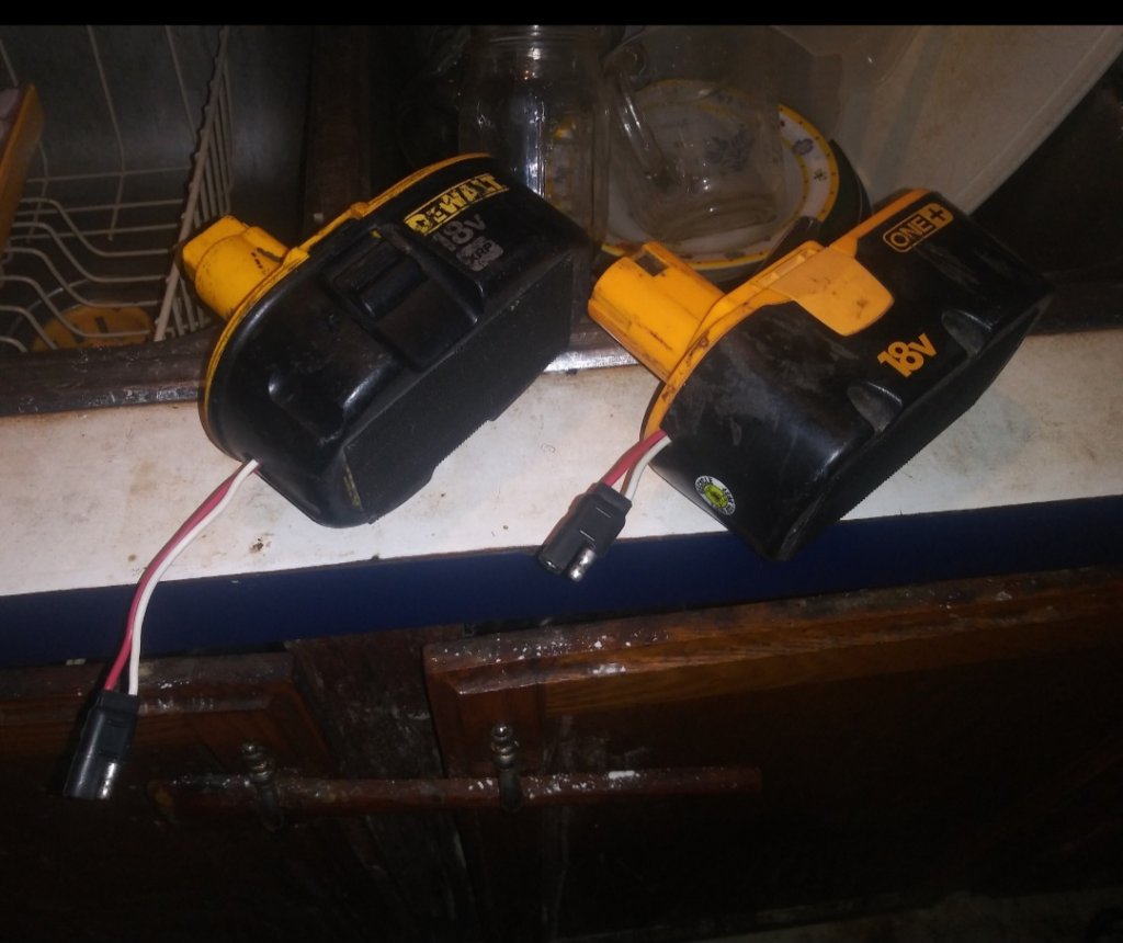

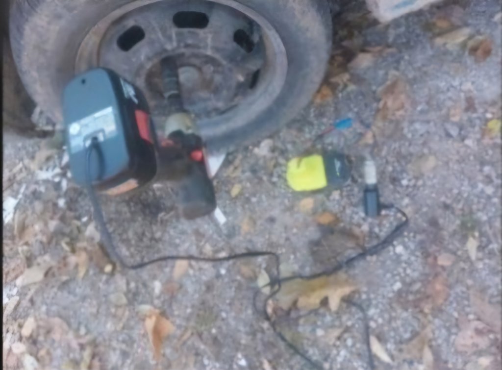

I'm 70 and as I get older my strength has diminished along with my age. I mainly looking for one to remove lug nuts and rusty bolts, use on changing the ball joints in my 02 Silverado 4x4 and to be portable while traveling. I haven't looked into whether the batteries are interchangeable between the 3/8" and 1/2" Milwaukee.
If you already have a 18v Milwaukee 3/8 then I'd follow it up with an 18v Milwaukee 1/2 drive. Other than that if you don't have an 18v Milwaukee already. I'd look at a higher tier 18V Ryobi,buy it local take it home,test it,if it works for your needs keep it. Here's the thing about Ryobi. When they changed to Lithium they made their batteries backwards compatible,plug and play. What this means is garage sale,pawn shop etc old Ryobi tools will work with your new Ryobi batteries. Another nice thing about Ryobi. Once a year they have a sale buy 2 batteries get a free tool. I had a DeWalt Kit, I have some Milwaukee,Rigid,Kobalt and Craftsman,even some Snap On. I run most everything on Ryobi batteries now ,and slowly am replacing everything with Ryobi. I made corded batteries,and made adapters,Ryobi has battery management in the battery for compatibility with NiCad tools.Everyone else betrayed me and wanted to force me to buy a new tool to go lithium.

Keep in mind with the adapters you have to know where the battery management is. Is the battery management in the tool,or Is the battery management in the battery. So you have a tool with no battery management in the tool and you adapt a battery with no management in the battery,now you have no battery management at all. Why does it matter? No control or safety over discharge rate and discharge volts. Outcome,possible ruined batteries or batteries on fire. I have a lot expierience with this, been adapting tool batteries for at least 10 years. Smoked 2 batteries in the learning curve.
