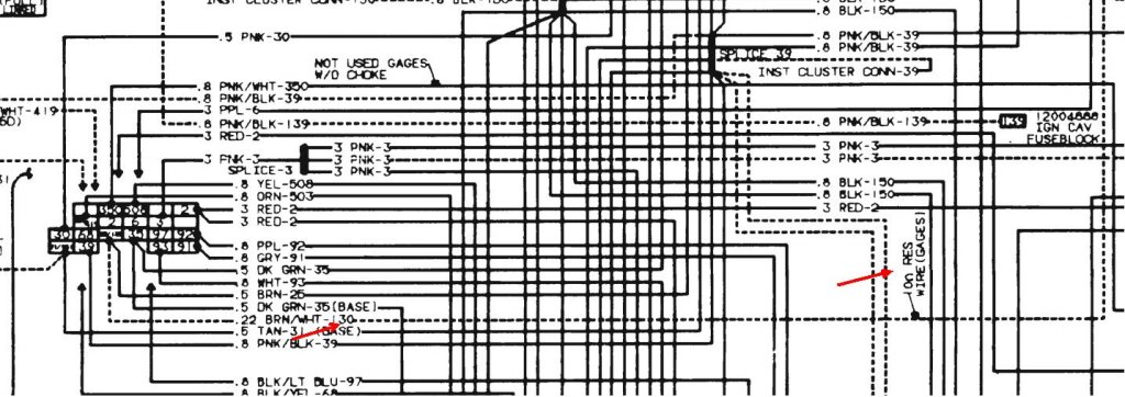

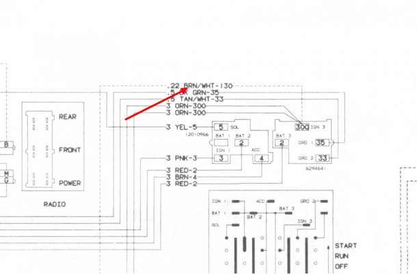

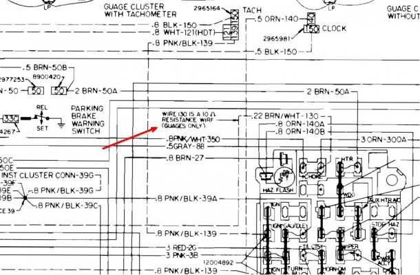

If a wire passes through the bulkhead, does it go through the fuse block, or do some bypass? 99% sure some bypass…just can’t wrap my head around why I can trace the wire to the bulkhead on the engine bay side, but nothing in the cab.
