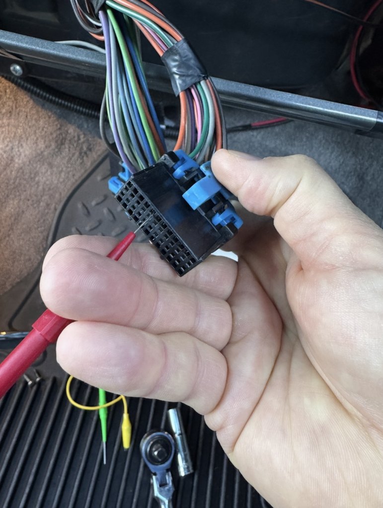

Funny you should mention. Mine isn't working either. Just starting to dig into it. Do you remember what color the wires were? Body shop replaced the cab and a few things aren't right. Thanks.

Based on the following, you should be looking for brn/wht. This is directly from the drivability manual found on this site in the squarebody reference library.
