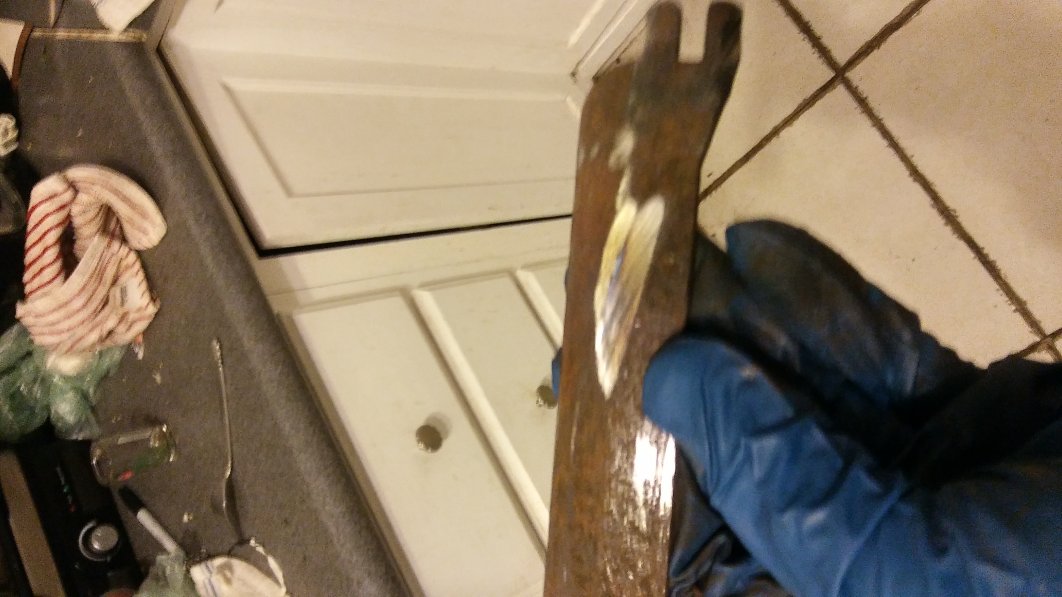

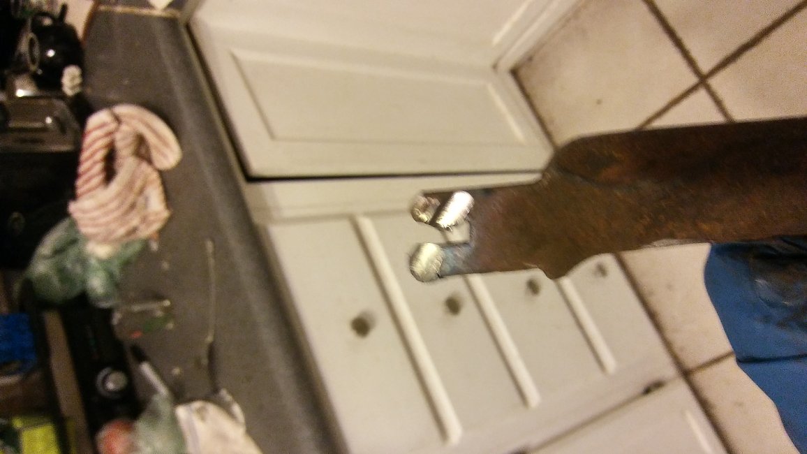

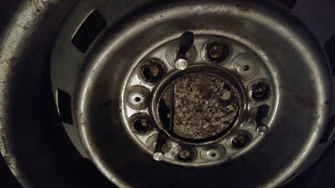

Screwing longer bolts in the hub cover holes popped it off but stripped one of the holes. I dont even care at this point. Images should be attached. Found this little guy just hangin out at the bottom of the assembly. Along with one of the shoe keepers bent 45°. I am missing the clip that holds the parking brake or ebrake lever through the shoe. Not sure what the part name is
Thanks for all the help i am working on scrubin all the rust off.

Great tip from retro, Glad you got it off finally!
47,817
10,952
Glad you got it off. I wouldn't worry alot about the stripped center cap hole. Tap it a hair bigger or just run 2 bolts with a dab of LoK Tight hand tool blue. Don't use the red **** though.
