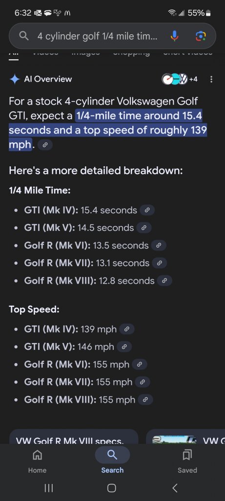

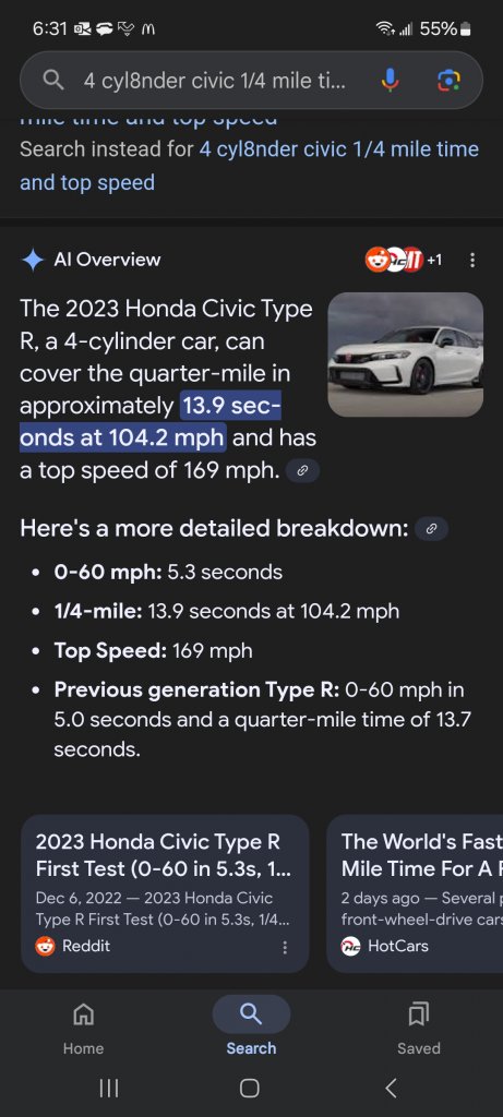

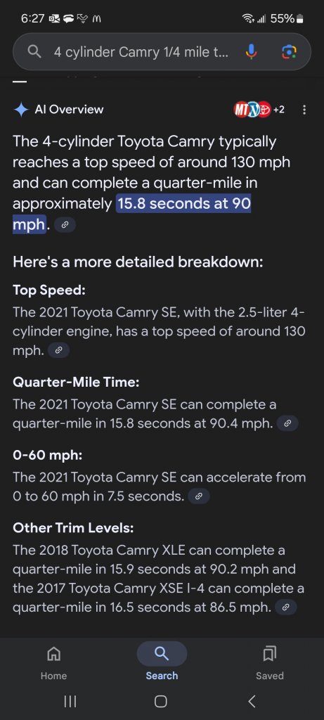

So true, but sometimes it's nice to blow by them and see the looks on their faces.
6,445
10,970
Good luck with that
