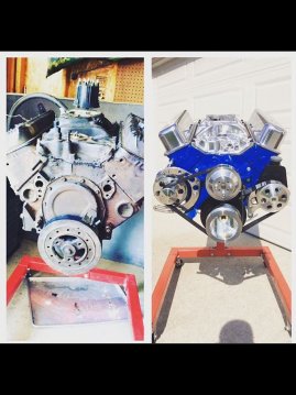

I have a 383 stoker that was all rebuilt, everything new. I just recently purchased all of the ignition parts such as MSD distributor, MSD box, MSD coil. I need to figure out what spark plugs to put in the engine for the best performance. If you have a brand you really like, let me know.
