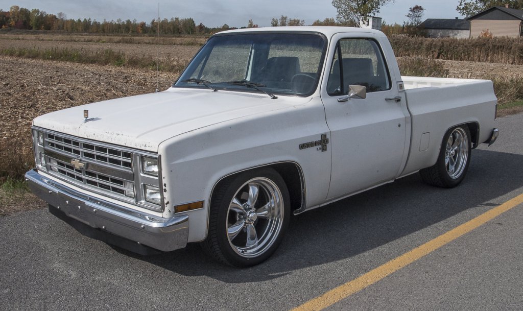

well my truck got a lot of part to add on:
2004 GMC Sierra 6L LQ4 LS
2006 GMC Savana 4L80E
2005 S10 cruise control unit and cable
2003 GMC Savana hydro boost unit
1999 GMC Sierra brake master cylinder
1999 S10 master oil brake reservoir
2005 Blazer 2 doors S10 Z52 rear sway bar
2000 Astro van steering shaft
1994 Olds 88 cruise control collum switch
1981 Z28 steering wheel
