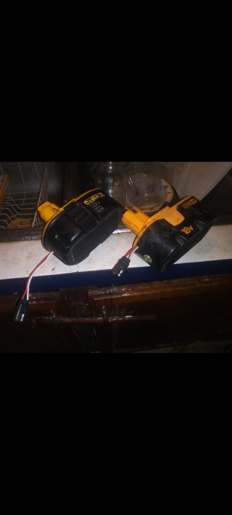

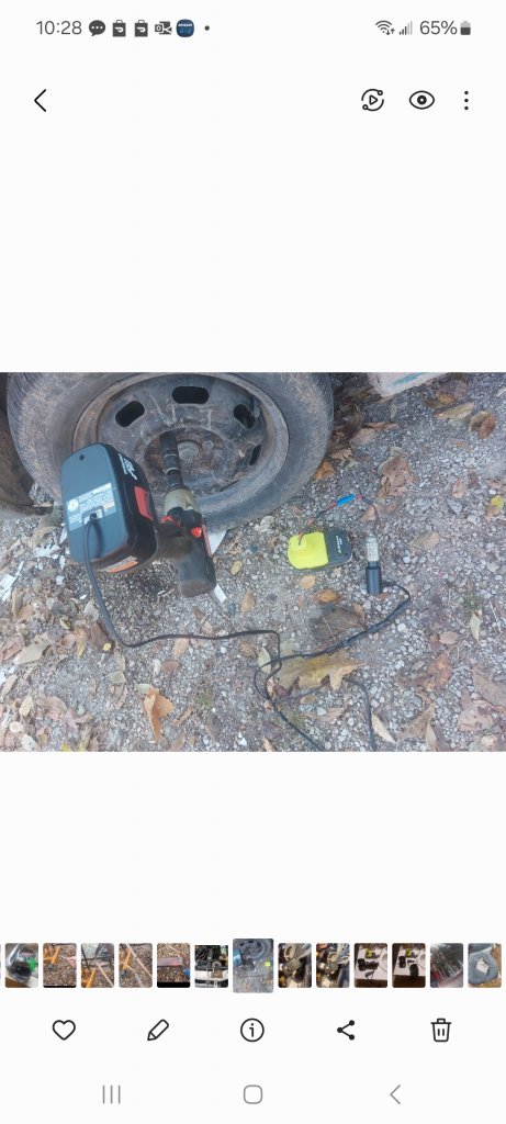

The way I started with this adventure I gutted 1 of each of my dead 18v nicads and put cigarette lighter plugs on them, I've got pics of 3 of them 1 was in progress pics.Theres a pic of my 19.6 Craftsman Impact in action powered by a Ryobi Battery , the green socket to fit the Ryobi batteries are like 2 for 15.00 on ebay they use them to use Ryobi batteries in power wheelers and electric scooters. So initial out lay 15 bucks in sockets,a bunch of cigarette lighter cords from misc,junk,I bought 1 Ryobi battery and charger for 25.00 on ebay,the rest was just my time. But I ended up being able to power 7 different brands with 1 battery yes they were like corded tools but I could take the plug in any where. Now,you'll wonder why I made a corded Ryobi battery, Because I didn't start by using Ryobi batteries initially,but they were the winner after four different attempts,based on cost,safety,and battery management. Eventually I started sinking the green sockets into gutted batteries on my most popular stuff. 1 more fun fact, you can use the Ryobi batteries and socket to power a 12v tire inflater( they work better on 18v). So I'm powering 8 different devices with 1 battery platform. I bought a lot of 10 dead new Ryobi batteries on ebay for 50.00,and brought them back from the dead. Not the way everyone shows on you tube,that doesn't work on the dead,dead Li Ions . Also put a cigarette lighter cord on my snap on 9.6v impact and a Bosch 9.6 drill so I can use them under hood, off a jumper box or anywhere there's a 12v automotive cigarette lighter. When I looked at the Dewault adapter I was going to have I think $200.00 in 2 batteries 1 charger and the adapter,so I went my own way.

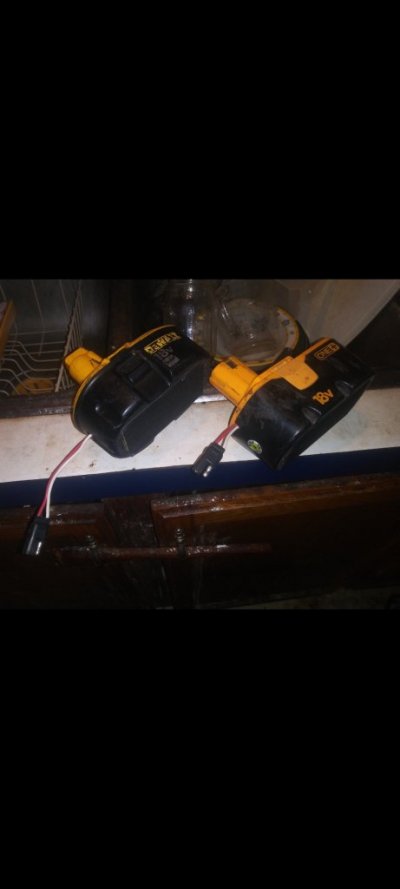

Could only put up 3 pics, here's a pic if my dewalt drill with a socket sunk in a gutted battery, it's about an inch thicker but I don't mind,and as I said before once yearly Ryobi and home depot come out with a special byv2 batteries and a charger,pick a free tool,my Ryobi collection is growing. I'm running Dewalt,and Craftsman ,this way usually everything else I just run as corded,cordless tools.

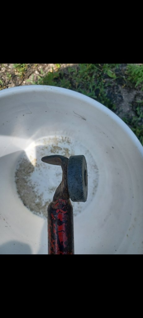

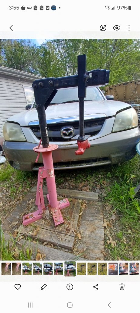

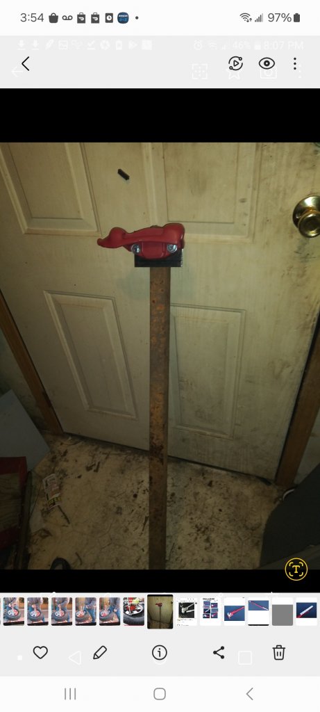

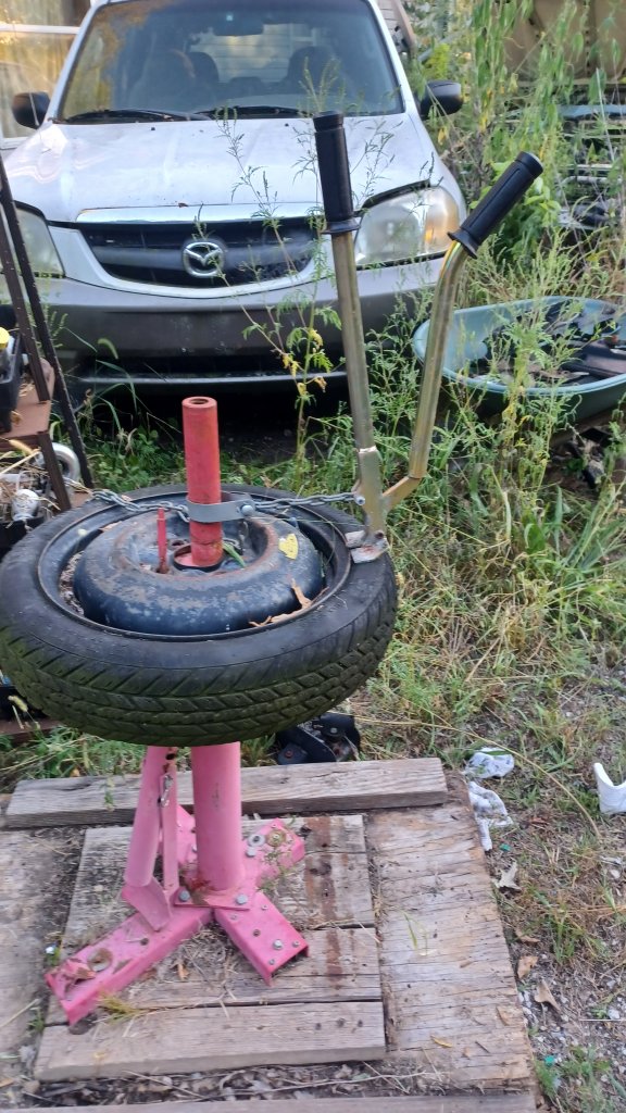

I've had one for decades, as is,it's junk, if you can weld you can make a better one. I've upgraded all kinds of stuff on mine,just to make it functional. The bead breaker doesn't work 90 percent of the time so I had to adapt a bead breaker from a different manufacturer. The mounting bar. Ha, forget it, it dismounts fine but you will be prying your new tires on with tire irons while the upright is in your way.. Mine is very functional now but it is no where near what it was when I got it. Now I can break a bead everytime,dismount a tire and remount any tire without having to pry them on. I'll try to find pics and put up comments so this will be edited a bunch. Keep checking back. Okay could only attach 5 pics,I made probably 6 different mounting bars none worked great. The bike carrier,turned into duck head works best. The bead breaker is a Speedway wide foot bead breaker,with back bar removed and a piece of chain and strap to replace the back bar. The round wheel looking pic with the hook is a pic of the head of an old Milton tireman tire bar,I bought, it works decent,duckbill on a stick,way better than the harbor freight bar. The bulldog tire lever,absolute junk,140.00 dollar junk. So the only part of the harbor freight tool I use is the upright. I've drilled holes in the round plate to bolt my wheels down. So if I were to start all over, I'd take a piece of scrap pipe weld a plate on bottom to bolt it down and a plate in the middle to bolt wheels to. Then I make a duck head mount and buy a speedway bead breaker. P.S. it was on that wood when the previous owner threw it away,because it was junk.
