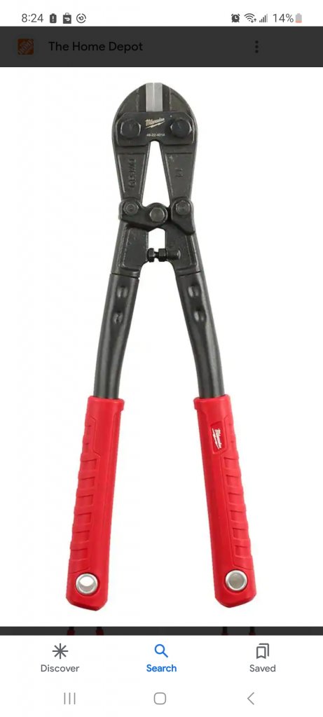

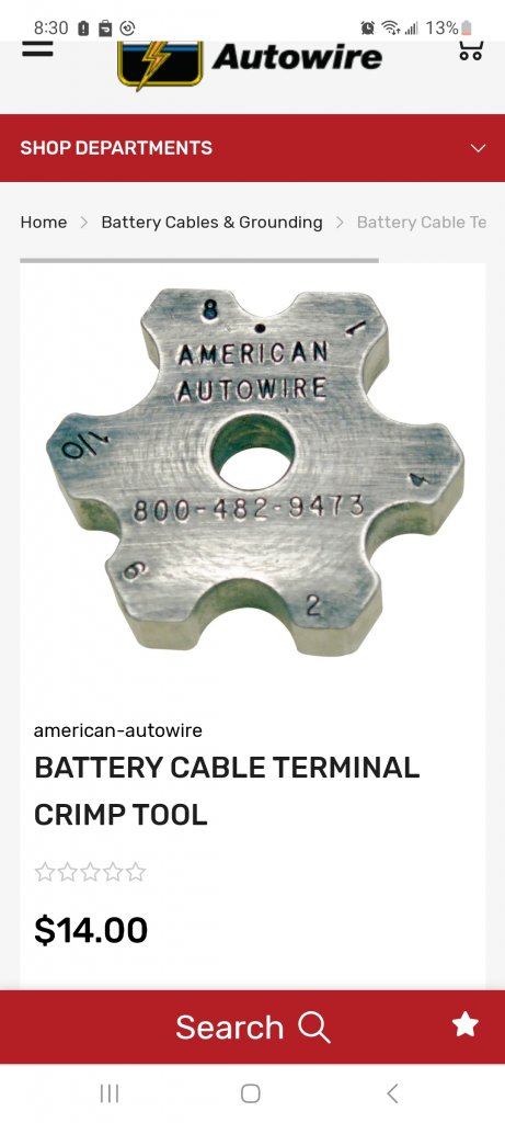

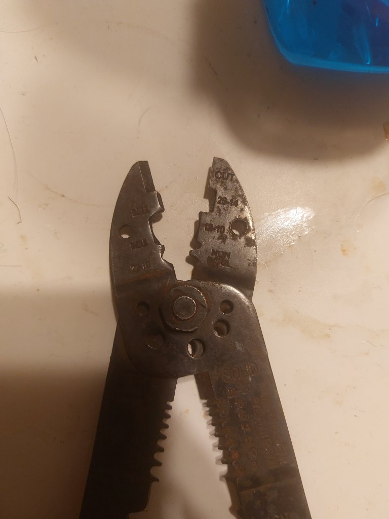

Since we are talking wire crimper, I've always wanted to just grind the jaws on one my 37 pair of bolt cutters to use as cable crimper. Thinking just grind triangle into each jaw so when they were shut the 2 would make a square. Or I could grind a half moon into each jaw and end up with a circle,but I don't know the dimensions for a good crimp, can anyone with round or square jaw crimper give me some dimensions. These into these,but bigger for battery cables ,Also have thought of grinding 1/2 moons in 1 side leavingbthe other jaw flat like the vise use like american auto wire crimper, if I have to by these to copy the cut outs.
