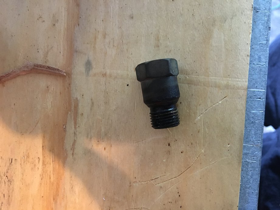

Changing spark plugs and this came out with one of them. What the heck is it?
454 on cylinder 4 for reference

Basically it's a spark plug extension shield to keep the spark plug electrode
a little further out they are generally used on an engine that is worn and burning oil causing the spark plugs to foul

Im bettin it aint there for no reason.
Those things are worth their weight in gold!
Put it back!

LOL, wish I'd known about em when I had the durango.

Do they not make those anymore?
I had an old 250 I6 that ran like a watch after I put one of those in #4 and #6.
