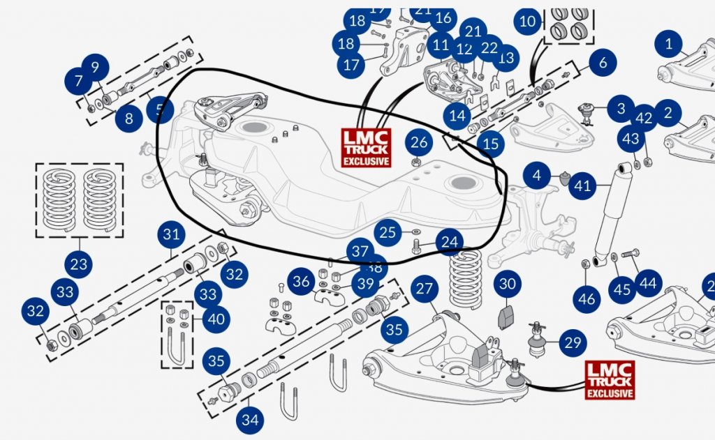

What is this part called?
Rooster81
Jan 24, 2023
22
TN
Bill
c10 swb

Sub frame?
The part that holds on to all the fun?

Front suspension crossmember

It’s just the front cross member or engine crossmember. Some might refer to it as the engine cradle.

Subframe is a complete front frame unit that is removable from the car, usually on unibodies that don’t have a full frame.

I believe the old gm videos called it the girder beam suspension, if I remember right they highlighted the whole crossmember. 2wd front crossmember I would say.
Also could technically be a subframe since it can be unbolted as a whole assembly, other than upper control arms I think?
