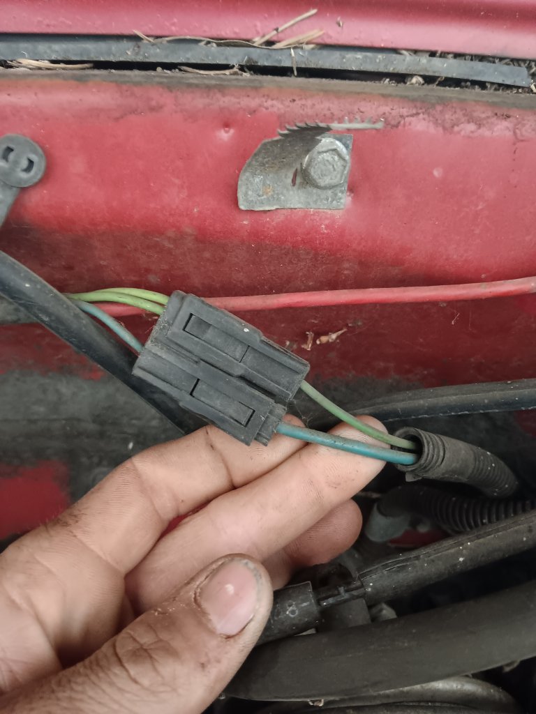

Need help please.
1983 GMC pickup factory AC. The truck came without an engine/tranny. It does have (most?) everything else at the firewall.
I've added the factory condenser, accumulator and replaced the evaporator. I've made all the AC lines.
It has the stock fan motor, motor resistor and relay.
What is this connector? It is OEM. It is in series with the 12v line that loops through the low pressure switch. It is not the compressor clutch connector (wrong location and wrong connector).
I'm guessing it's some sort of AC cycle switch but if it is, I'm missing that switch and don't know where it would mount.
Any help would be greatly appreciated. I feel I've searched the entire internet, twice :(

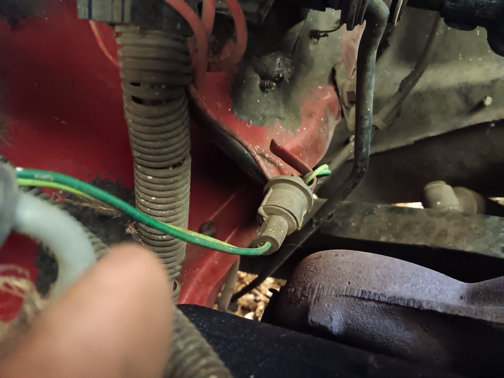

I believe this is it. Goes or comes to that round one below column. By exhaust.
That looks like the right connector, but I don't have the pigtail with the round end. Can you tell what the round end eventually hooks to?
Thank you.
Thank you.
I'll look when I get home

It goes into the wire loomed harness that goes along frame above fuel tank to tail lights. I'm guessing it goes the other way tho.
Yes. I'm guessing it goes into the cab.

Do you have a multi meter? Use the ohms to help trace the wires inside and use a jumper wire to make your leads long enough to check continuity. I wonder if the wires are in there but just cut.

Thanks to everyone who responded. I found an original (complete) example. That connector plugs into a 'pigtail' that leads to the throttle (idle-bump) solenoid and then onto the compressor clutch.
