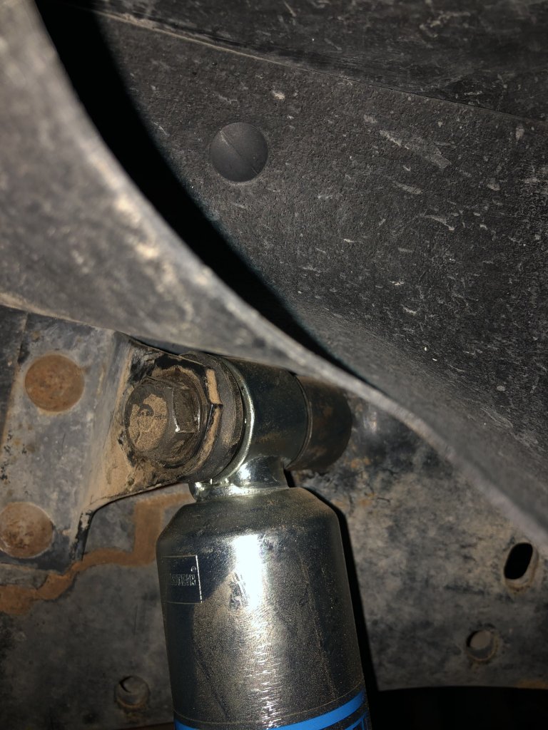

Anyway,I had a clanking coming from my front passenger side when going over bumps,rocks.Determined the noise was coming from the shocks.What it was,is the inner sleeves was to small for the factory bolt.So I didn’t use them.This was causing pre mature wear of the bushings.Installed new bushings and made sleeves from leaf spring sleeves.Fixed the issue.Does anyone know if the spacer on the upper shock mount goes against the frame or does the shock bushing go against the frame?Was looking at the angle and it seems like it would be better for the shock to be against the frame?

I know you have quite the squarebody knowledge.What do you say to those upper spacers?

This spacer

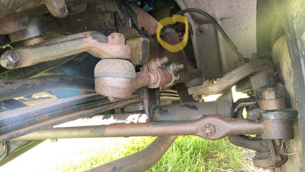

This spacer
you have a 1 ton so if its different Im not sure
heres some 3/4 ton stuff, no idea on if its applicable or corect(except the one broke off, that obv not right)

Thank you ma’am.Looks exactly how I have mine.
