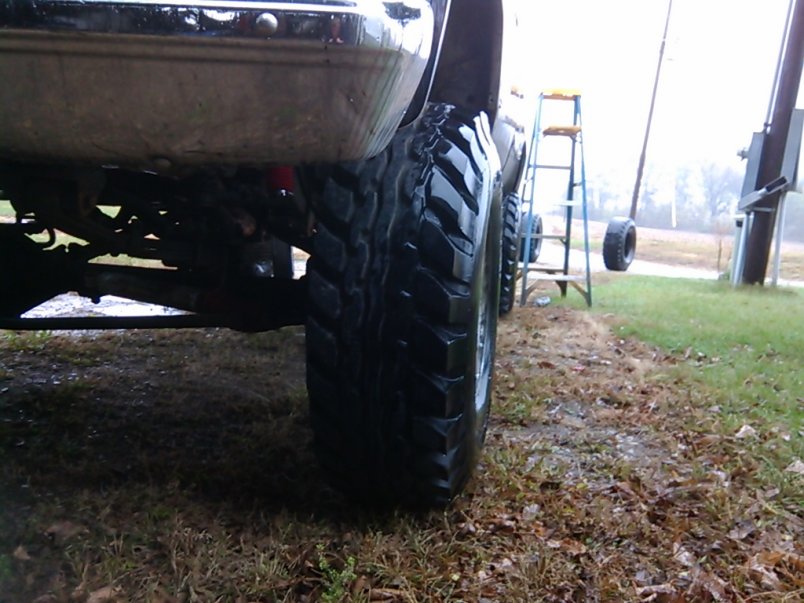

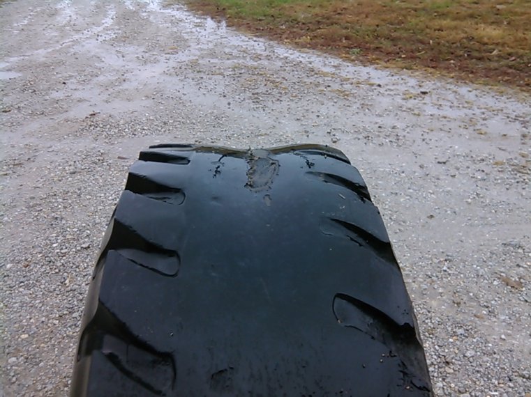

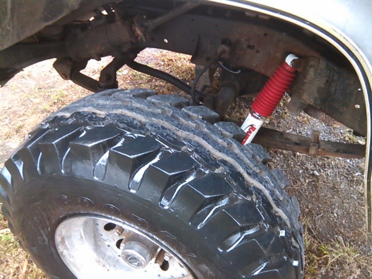

Tires and shocks
Some new ranchos 200$ and 36-12.5-16.5 90% tread military tires for 600$
Safe to say I got every mile out a the old ones
