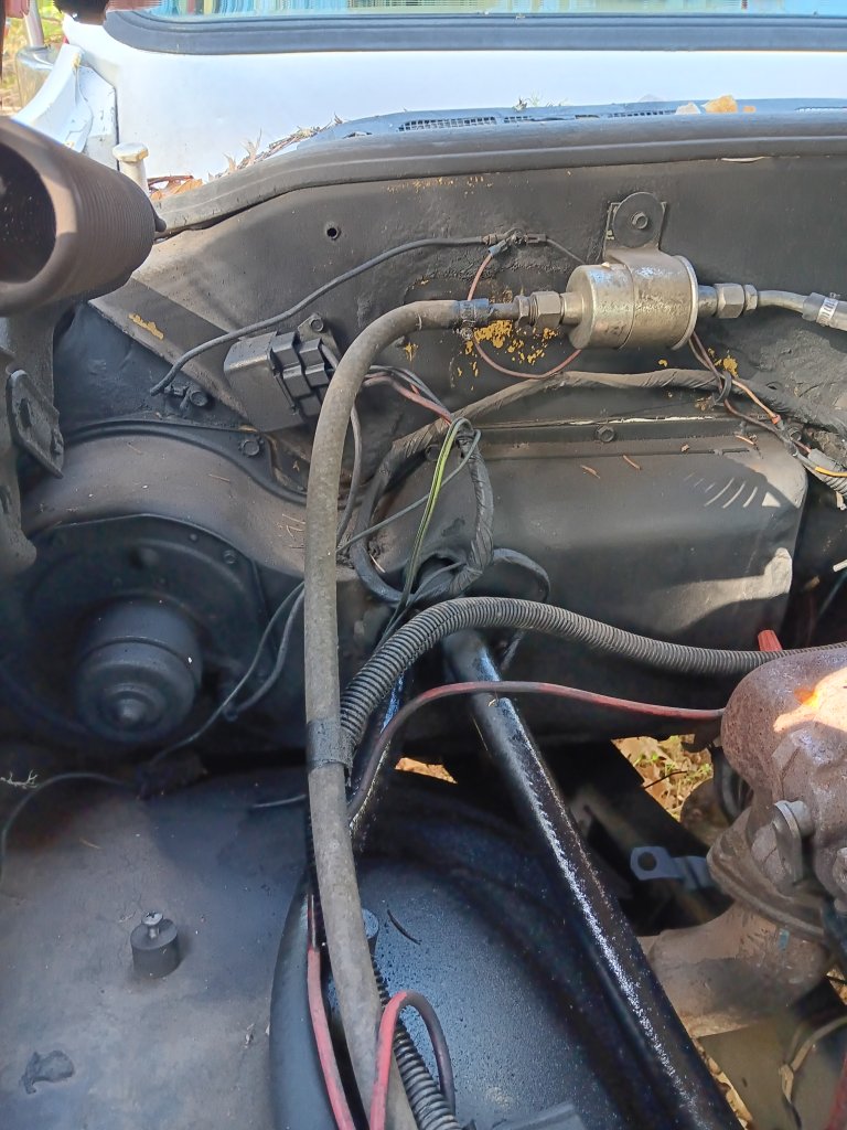

Started the fab work for my AC to non-AC swap. Might as well do it whilst the motor is out. Ignore the welds, still trying to master my new-ish welder. You don't have to be the best welder, just a really good grinder ;)
Looks good! I know this is a few page's ago but i thought id share what I did to my 78 when i converted a/c to non a/c to make room for the turbo. I alongated the non a/c fan housing to cover the hole and used existing a/c heater core and blower motor resistor. The heater works good that's all I care about.
that's very well done. great work

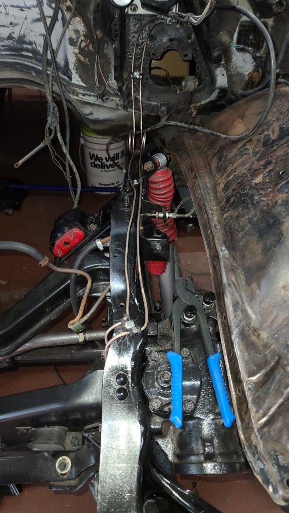

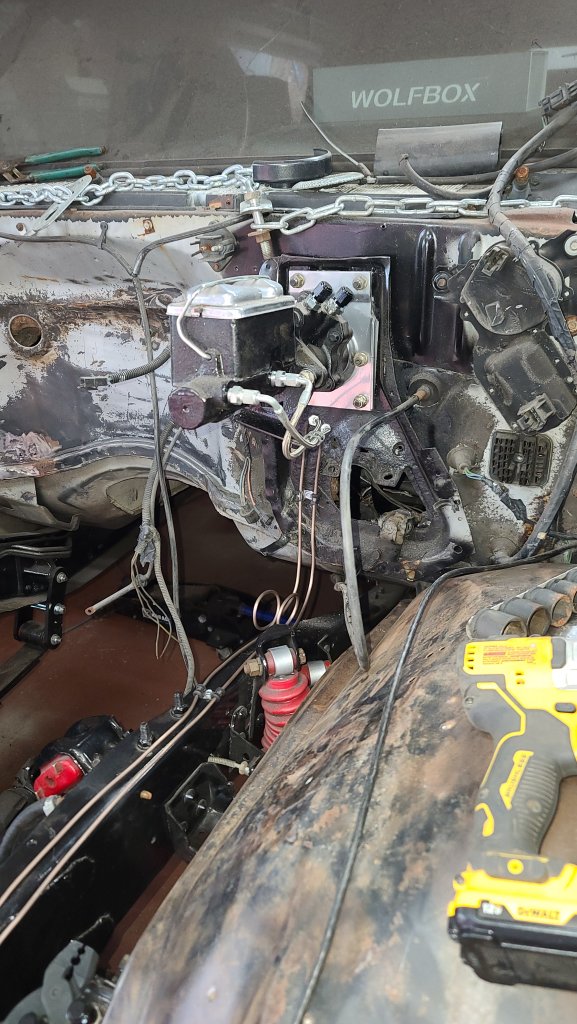

Made new brake lines from the proportioning valve to the master cylinder. Got to use the AN-3 brake lines I got from a member so years ago. 45 deg at the proportioning valve, and 37 deg at the master cylinder. Got to use both of my dyes in my brake line flaring tool.
