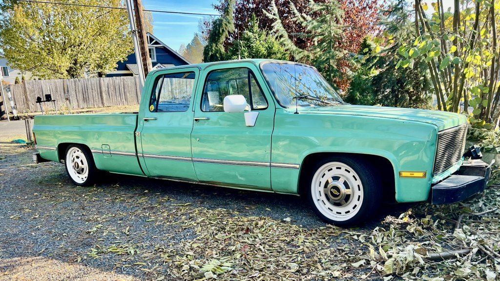

Pic prior to air ride…

I love those big hoops with the OE wheel covers. That’s the first time that I’ve seen that setup. That is a clean and straight ride that you have there. Welcome to the site too.
HS
Thanks, yeah I wanted to keep it somewhat still looking like a forest service truck. It looks a lot cleaner in photos than reality as it’s pretty banged up but that’s what still allows me to use it as a truck.
