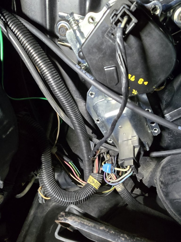

1987 v10 Silverado the wipers work slow fast and park but no wash I tested pump to battery it works
there is power to pump pink and white going to pump pink has power with key on I bought new wiper switch
and just plugged it in did not install in Colum did not work what next to try ? I think there is a wire missing
off of white wire there is a wire connector with a small cut wire coming of near plug see picture
thanks for and advice or where to try next

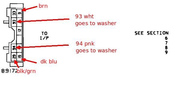

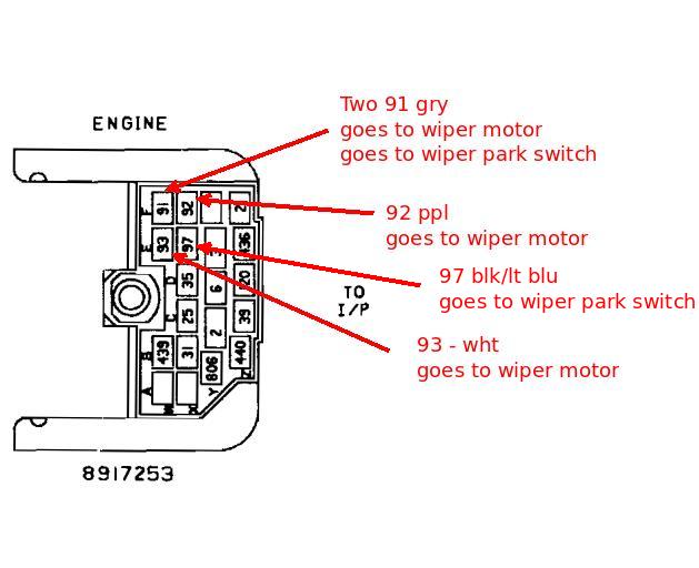

Does the white wire at the washer have ~12 volts? If it does, the pink wire is probably not getting to ground (broken or loose connection etc..)

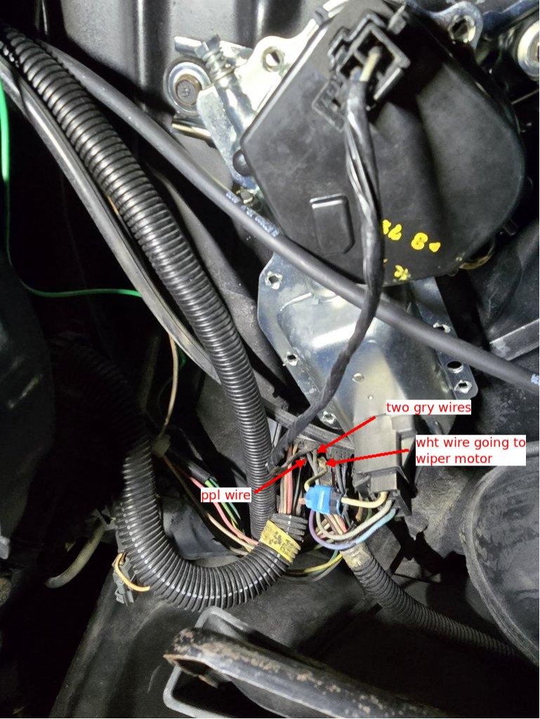

In an 87 v10 your bulkhead (going through firewall) should be similar to the two attachment. I am unable to see the portion that the washer pnk & wht go to in your picture.

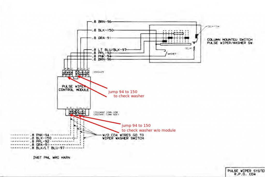

If you have power on white wire at washer and the pink wire appears good to the bulkhead- you could use a piece of wire to jump the pink connector to the black connector at the module to see if the washer works. If it doesn’t -next- remove the module and use the wire to jump the pink and black wires at the connector directly . FYI the wire connector will plug directly into the switch without the module. (The module just adds delay if the module is working correctly)
You mentioned, in another post earlier, the wipers work on hi and low- that indicates the black wire at the module is grounded correctly.
