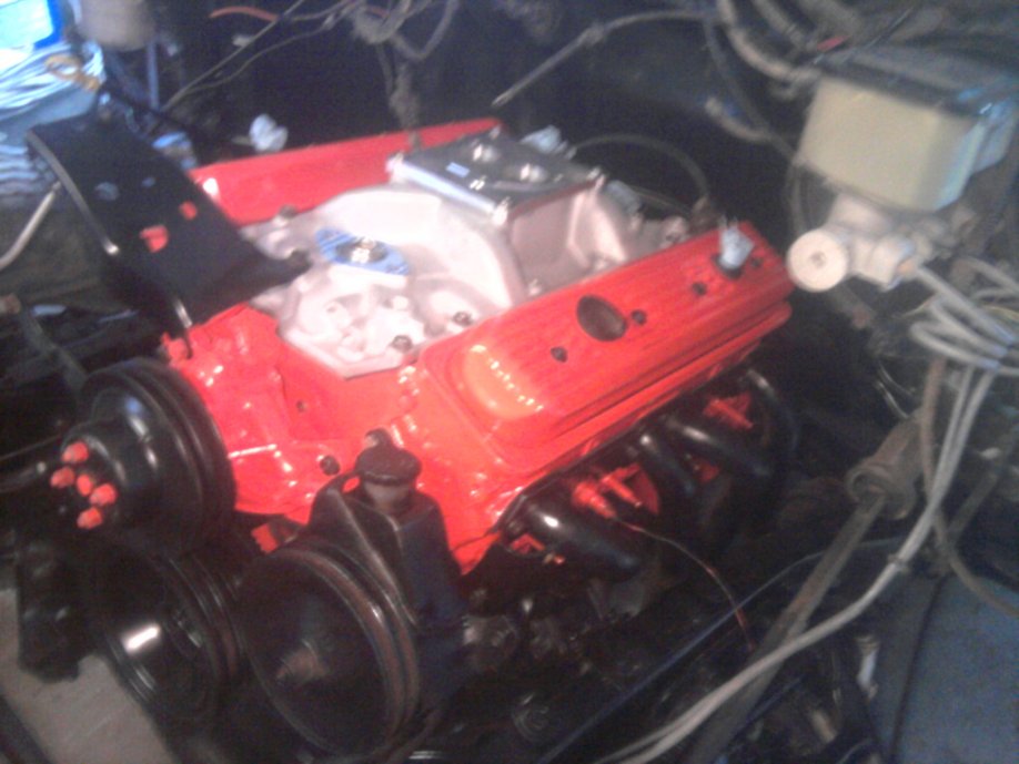

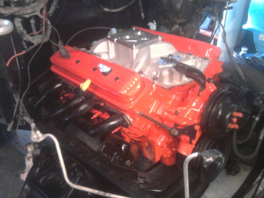

I was going to put a 99 vortec 350 in my barn door blazer but I picked up a 5.3 instead.
I bought a carbed intake and a tbi adapter to bolt a tbi to the intake
and I was going to have a custom chip done to delete the egr
but the 5.3 will take its place and the 350 will find a new home later

Carb intake will cost you EGR, and a custom tune is mandatory. You will love it though.
