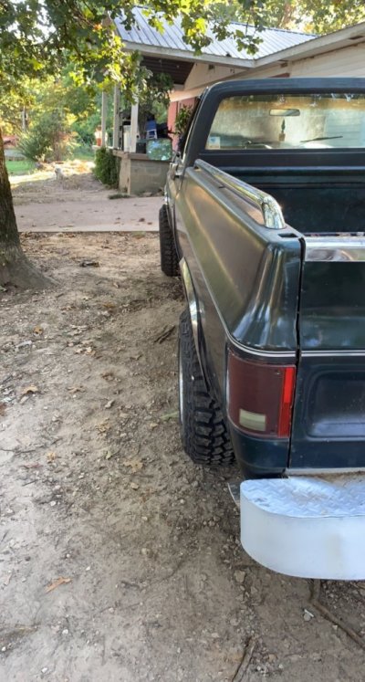

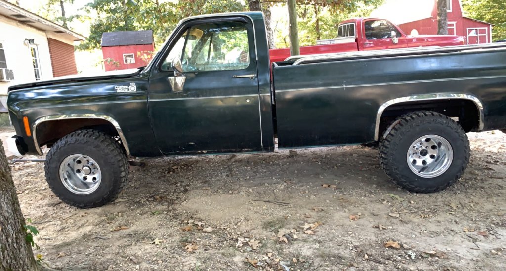

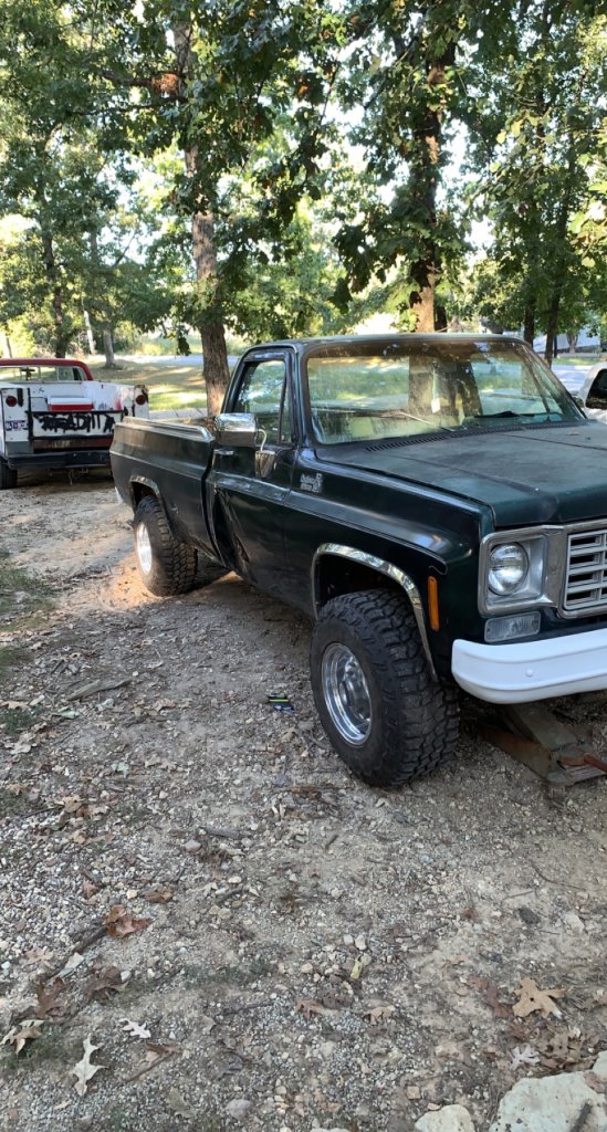

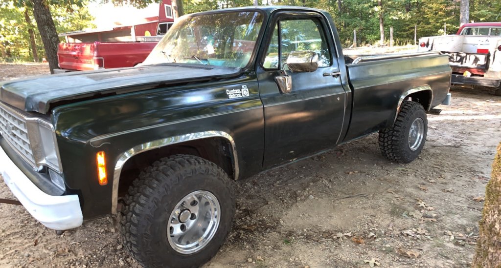

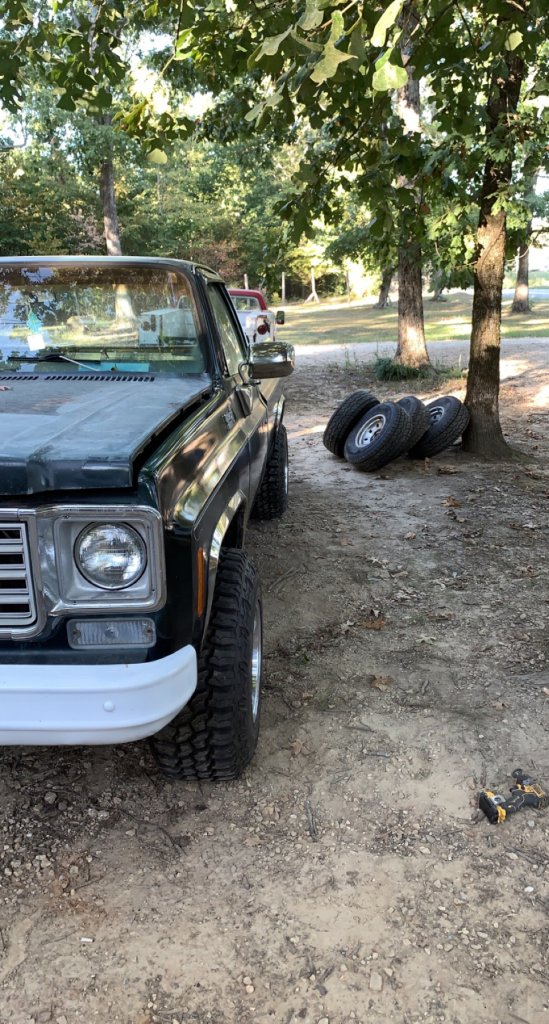

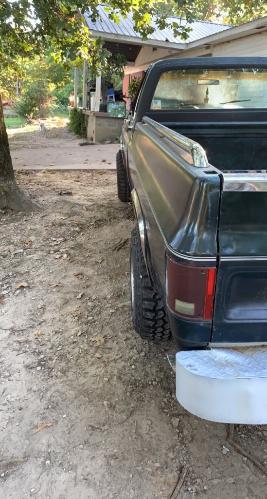

Since I’m not positive if this truck has been shown or not, here’s some photos with the new wheels and tires I just got. 15x12’s with 32x11.50x15.
