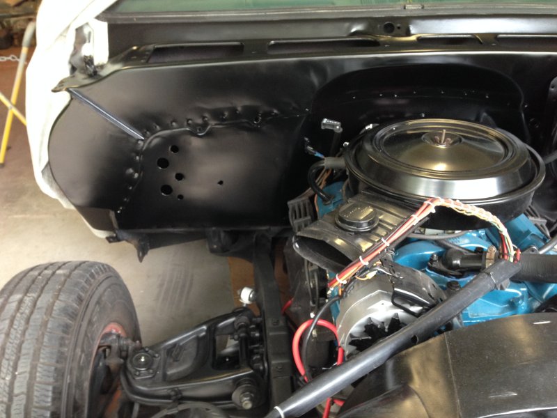

I am in the middle of a VA install. Mine was an AC truck and I welded up the original AC holes and started from scratch. Easy install so far. Everything is labeled well and its a complete kit down to the hoses all ready crimped. It also comes with plates to block off any open areas in your existing firewall.
Got mine from this guy on Ebay. Call and talk to him, I got a better price shipped than the price on the listing.
http://www.ebay.com/itm/111006240469?ssPageName=STRK:MEWAX:IT&_trksid=p3984.m1423.l2649
Pic of my firewall ready for the kit.
