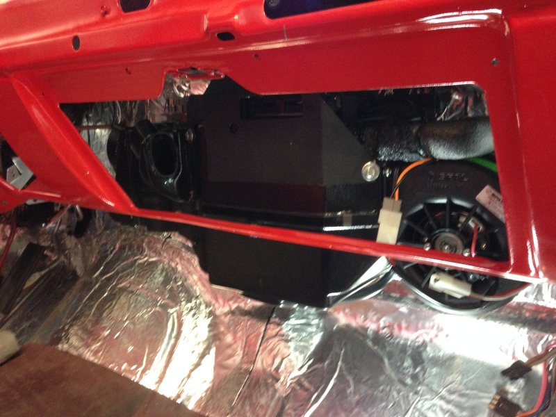

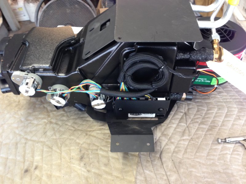

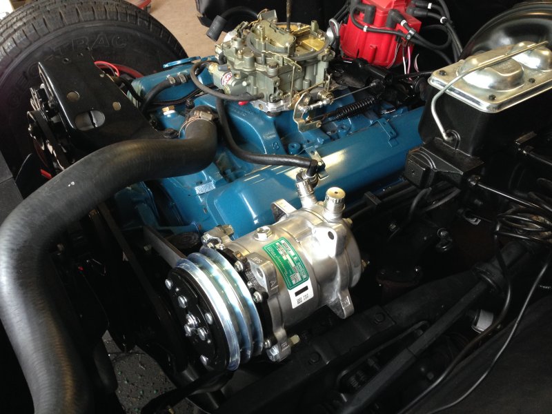

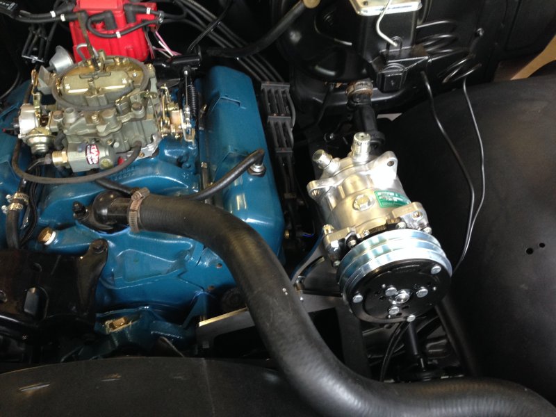

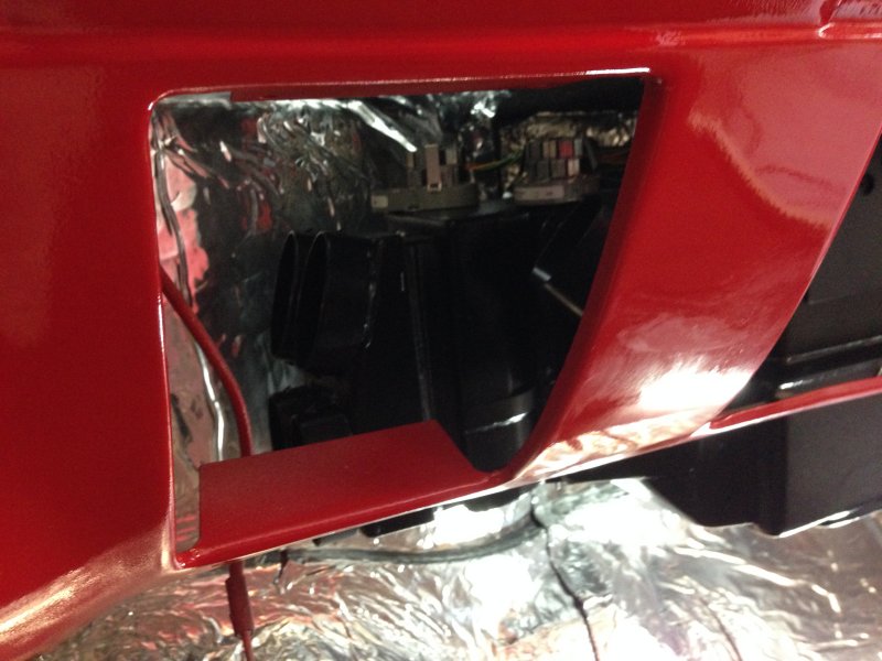

Here are some pics of the evaporator and compressor installed. Hopefully I will get the condenser and related parts installed this weekend. Compressor will come back off and I will powder coat the brackets.
