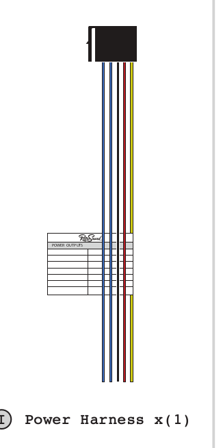

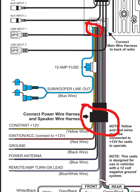

Since I don't know how you disconnected the radio, I'll mention my next idea. Did you check the connectors. The red & yellow wires are next to each other. If they were touching that would allow constant power to bleed over to accessory. - Just a long shot.

@Turbo4whl I can only speak for mine, but Retro has two 12v wires running to the radio for power. On my 85 k10 - One is the original yellow wire running to the fuse box (Radio fuse) -Retro changes it to red. This is the accessory power. The other wire is spliced to the cigarette lighter feed (orange)- Retro changes it to yellow. This is the battery feed for the memory (it has an inline fuse). This was spliced by a PO for an old aftermarket radio. It was/is very common to splice it at the cigarette feed for constant power.
