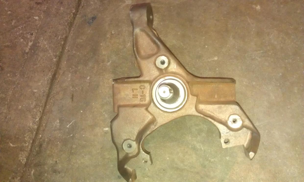

I acquired a set of what look to be drop spindles. I unfortunately do not know what they fit exactly. C-15 rh or lh are the only #'s aside from dates. Help please...

See if it has a manufactures name on it or a part #.

Measure the spindle & rotor areas & we can figure it out.

Looks like Bell Tech or Ground Force 2" drop spindle, for a 88-91 or 92-98 cant tell for sure but it definately has the caliper bracket shape of ~GMT400.

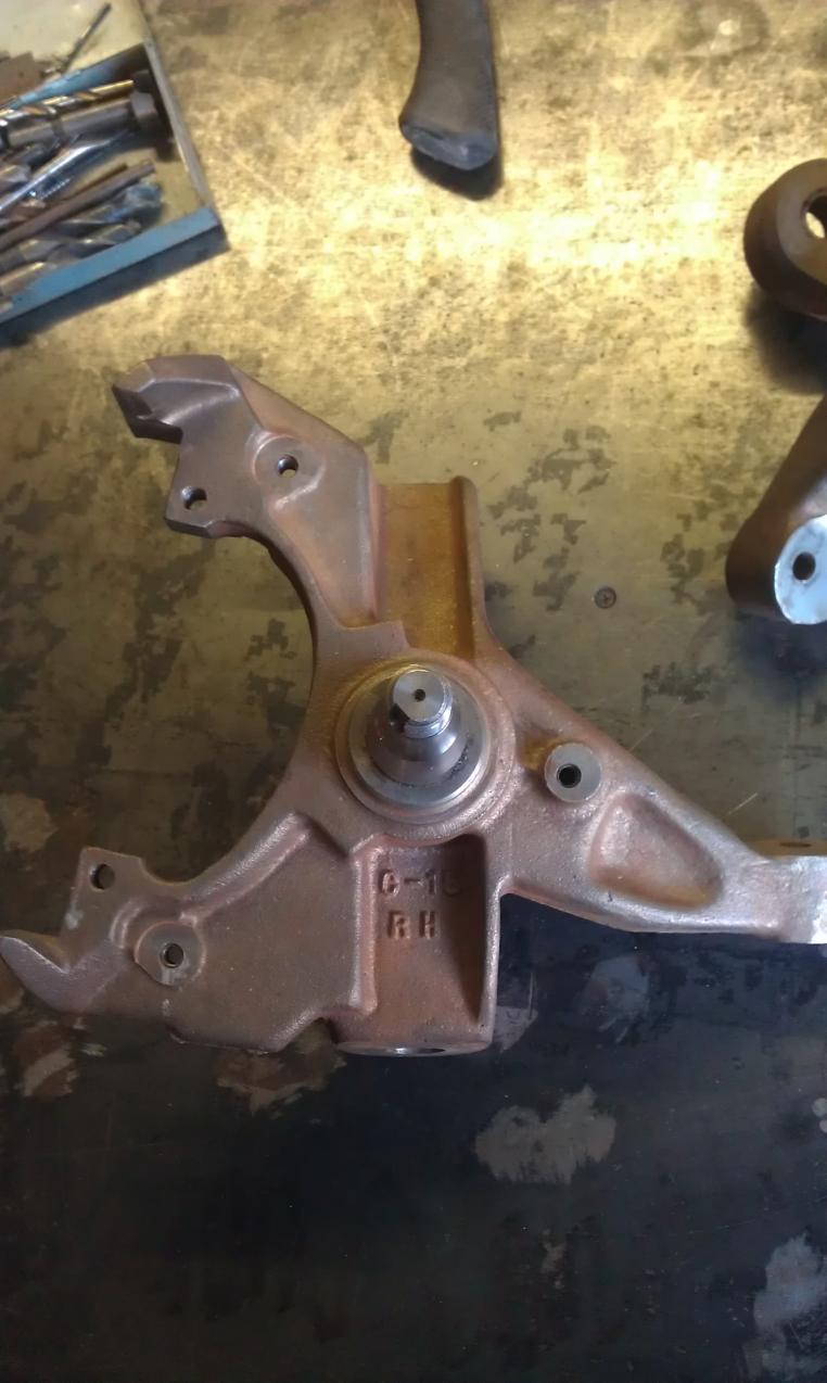

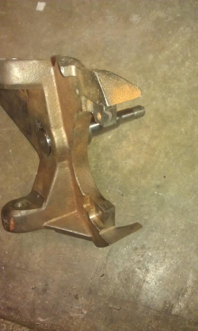

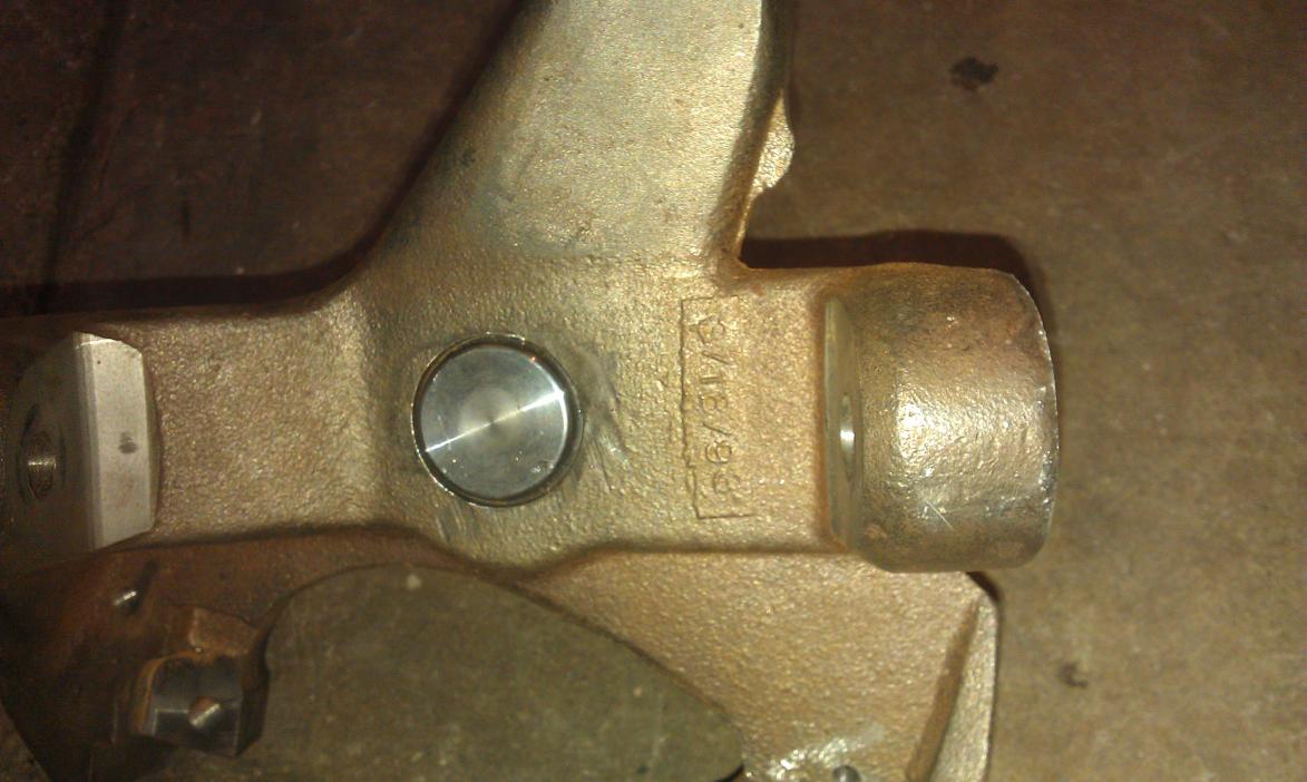

With a second opinion and a few pictures I've concluded these are for 88-98 full size trucks, no specifics as there are really no ID #'s or castings of logos. Here are more pictures though, notice the 2nd pic has 3/18/93. Old spindles or does this indicate what year it fits. What kind of measurements? The guy I got these from was gonna scrap them, I knew they were Chevy truck of some kind. I know now I can't use these on my 85', but if I can identify them 100% I can barter/sell much easier. Sorry for the small pics, not sure how to upload any other way just yet. Knowledge is priceless, thanks for the help.

That looks like a casting date. But it does have C-15 on it. Curious.

Measure one of them and I will measure one of my stock spindles I didnt throw away yet and we can compare them to give ya a better idea
