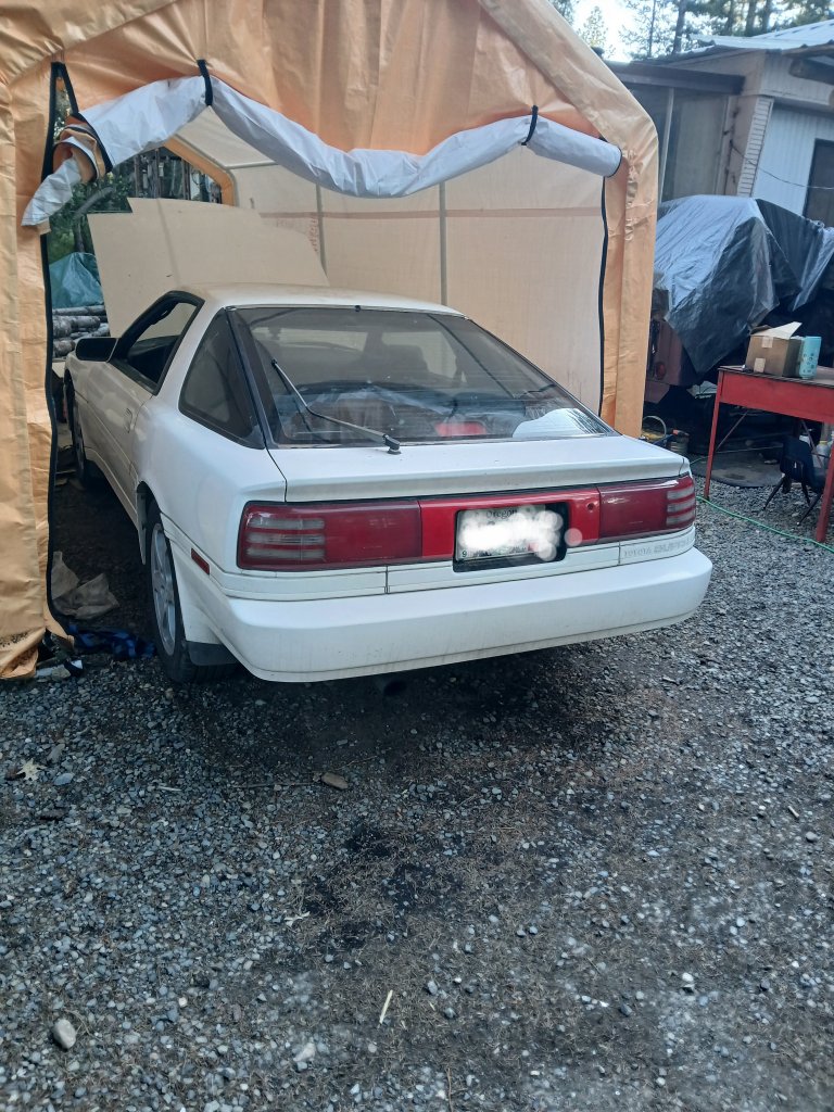

Going to do head gaskets on this on this in the near future
