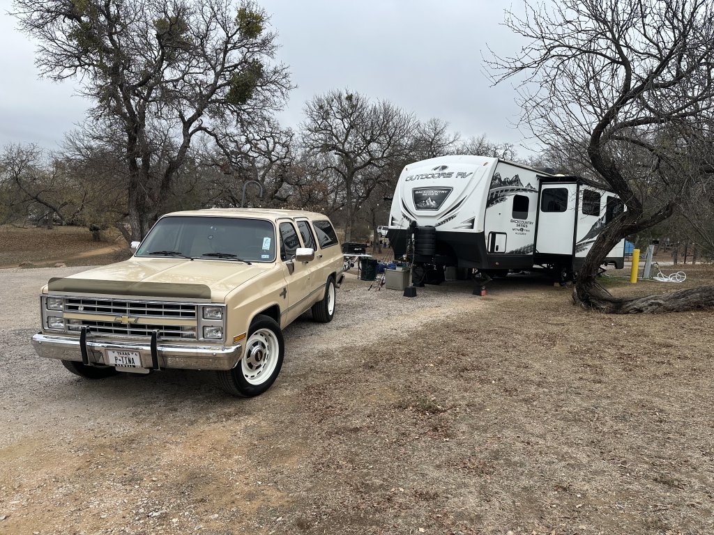

While it’s possible the tires are a contributing factor, first off you didn’t mention trailer sway or wiggle which is where some of the responses are leading.
But your numbers above don’t make sense at all unless you have a VERY nose heavy trailer.
If you need 60psi in the bags on top of 3/4 ton springs AND a wdh properly setup that makes zero sense.
For comparison 60psi is about what it takes to handle 4000lbs in the bed under 3/4 ton truck springs.
And your wdh should largely or completely negate the need for bags.
Those jumping on the tires as the cause doesn’t math out. Assuming a 275/55/20 117 load index tire you’ve got about 2800lbs capacity.
id be surprised if you had more than 5600 lbs on the rear axle. Or the same even if your wdh is doing its job.
IMO you need to check your actual numbers and tire rating and know where you’re at. A lot of speculation here with tires.
However as load rating is largely a function of tire pressure and air volume (yes that’s why low pro = less capacity than taller sidewall profiles.) if you suspect it’s soft tires causing the squirm translating to twitchy steering, just air them up more for a short ride to verify.
You will not hurt anything doing that. I’ve run 1/2 tons a lot with 45-51 psi max tires at the 60-65 psi range to stiffen them up with heavy tongue loads.
Again though your published numbers 60psi airbag and a wdh don’t make sense as stated above.
Another example. Full load bearing toyhauler with a 1500lb plus tongue weight takes about 40 psi to level back up on an avg 3/4 ton.
Another factor, how much towing experience do you have? Is this a problem or just to be expected? What is your basis for comparison?
Thanks for the response. The empty weight on the trailer at the scales was around 8600. Im assuming that we probably add 1000 pounds once loaded but I need to verify this. Typically my tounge weight measures in between 875-950 pounds based on the tongue weight scale I have. Once this is set, I then have to adjust the weight accordingly to the weigh safe app via the hitch adjustment.

arr you measuring the trailer and truck on this scale? thats.. .a heavy trailer for such light payload
If it is, subtract your trucks weight (4-5,000 pounds id take it?)
Still heavy but changes things considerably
Trailer only. This truck weighs around 4600

28dbs outdoors rv mtn trx travel trailer:
what kind of tires is the camper using?
And an idea i just had
While pulling it, manually apply the trailer brakes just a bit , does this improve or not change the issue?
35,425
44,729
Tires being run anywhere remotely close to their max load rating are going to handle poorly compared to a heavier rated tire.
A good and sturdy tire is the #1 most important item for towing. In my experiences, 8k isn't that heavy of a load for a 3/4 ton Suburban, even without any sort of weight distribution.

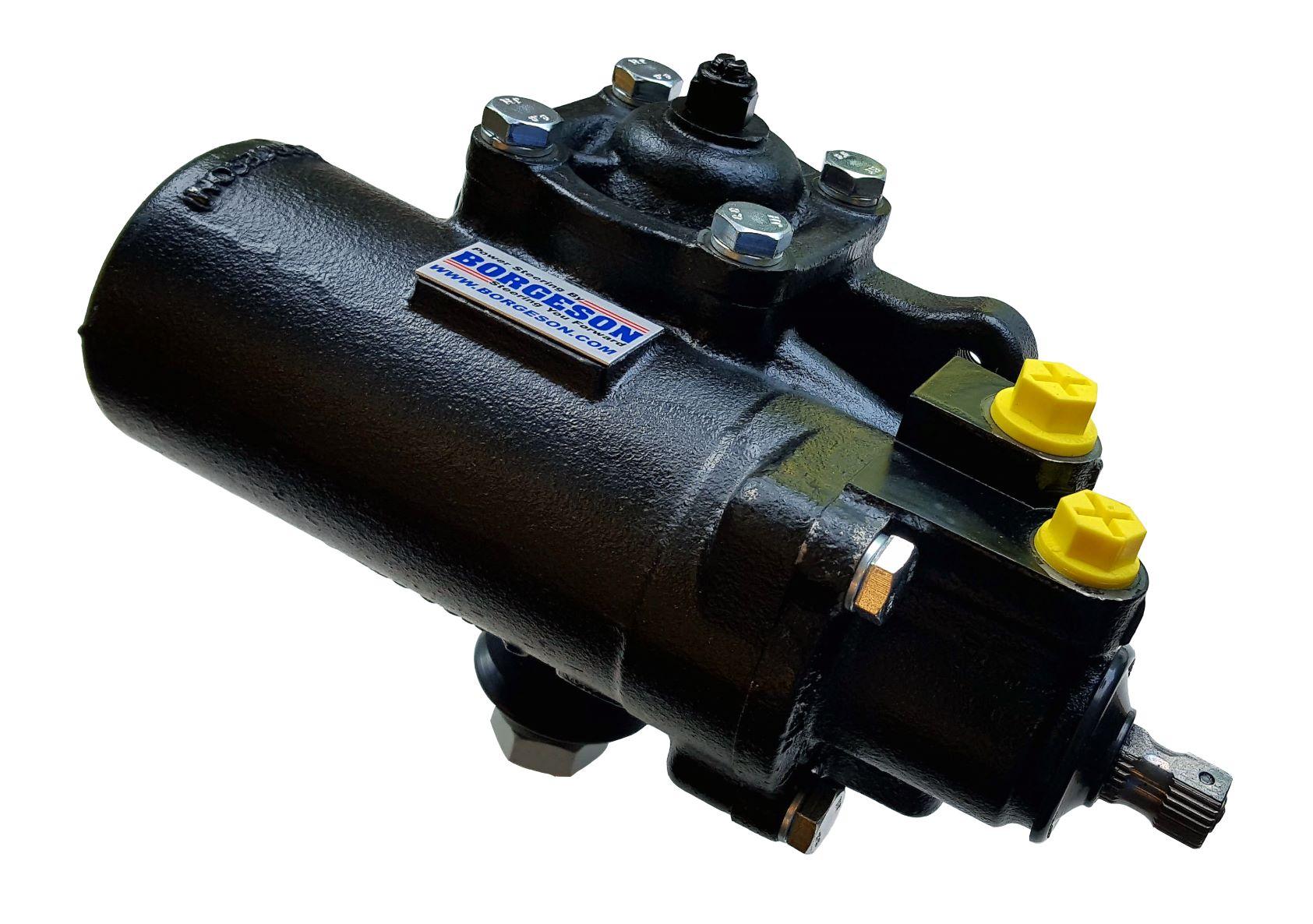

Driving it home tonight even without a trailer I can feel the light twitch in the steering. It’s almost like it tracks and darts quickly from one side to another in a short amount of steering wheel turn but drives straight down the road. Maybe I need to look at my alignment.
35,425
44,729
It's possible. You said you installed a quick ratio steering box? Both of those can amplify the effects of overloading tires when towing.
Yessir. Borgeson:
